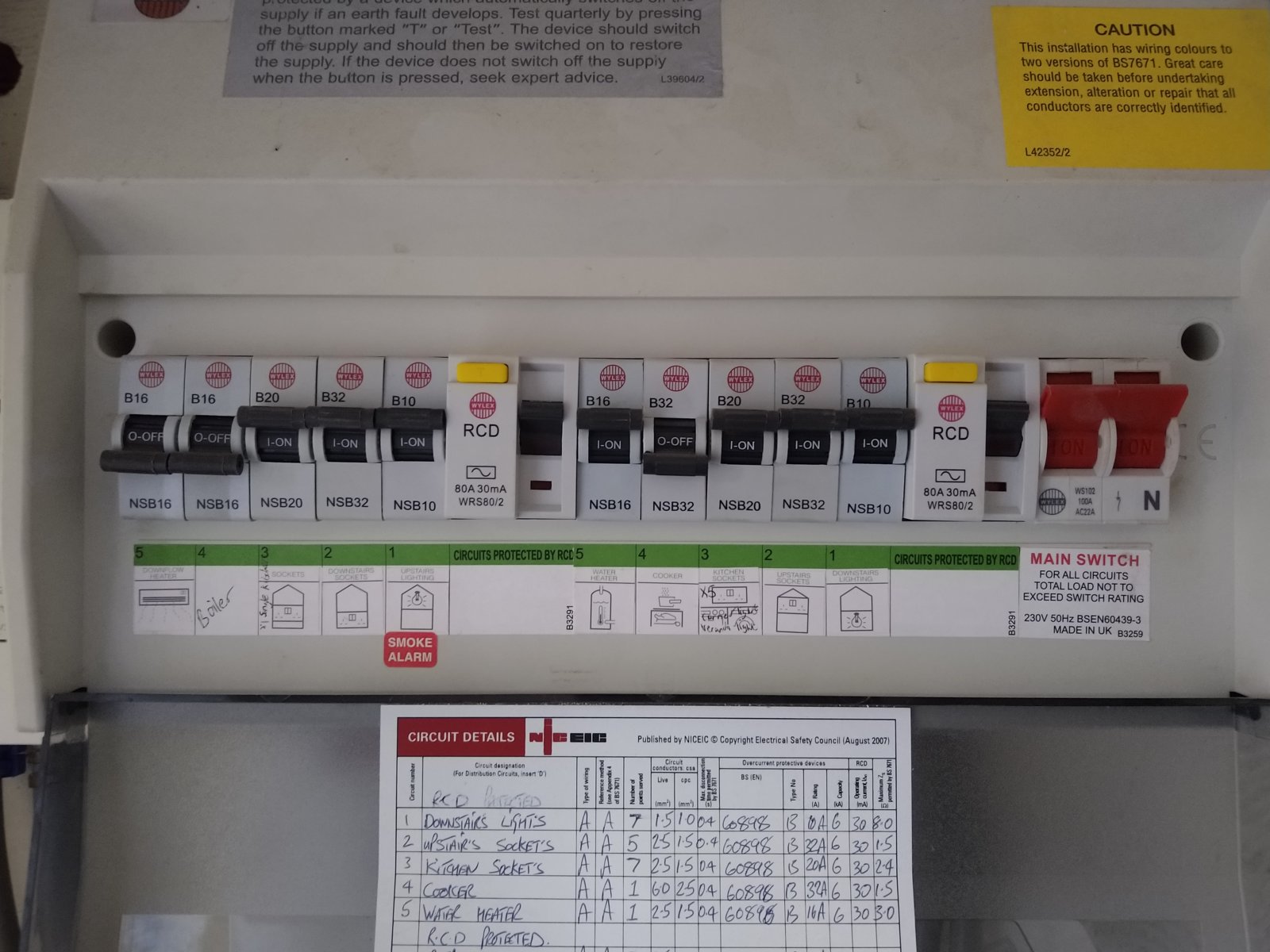

Hi,
I'm re doing the bathroom and need to wire up mirror light/shaver socket/fan. I have one now redundant cable that ran a fan heater, its on its own 16A RCD.
I'd like to use a connector block to wire these together so I can easily isolate all bathroom electrics (live to live, neutral to neutral etc) Is it ok to do this? The 3 cables will draw no more than 50W in total.
thank you
He can fit a switched FCU with a more appropriate fuse in it.
or
those could all be fed from the lighting circuit.
