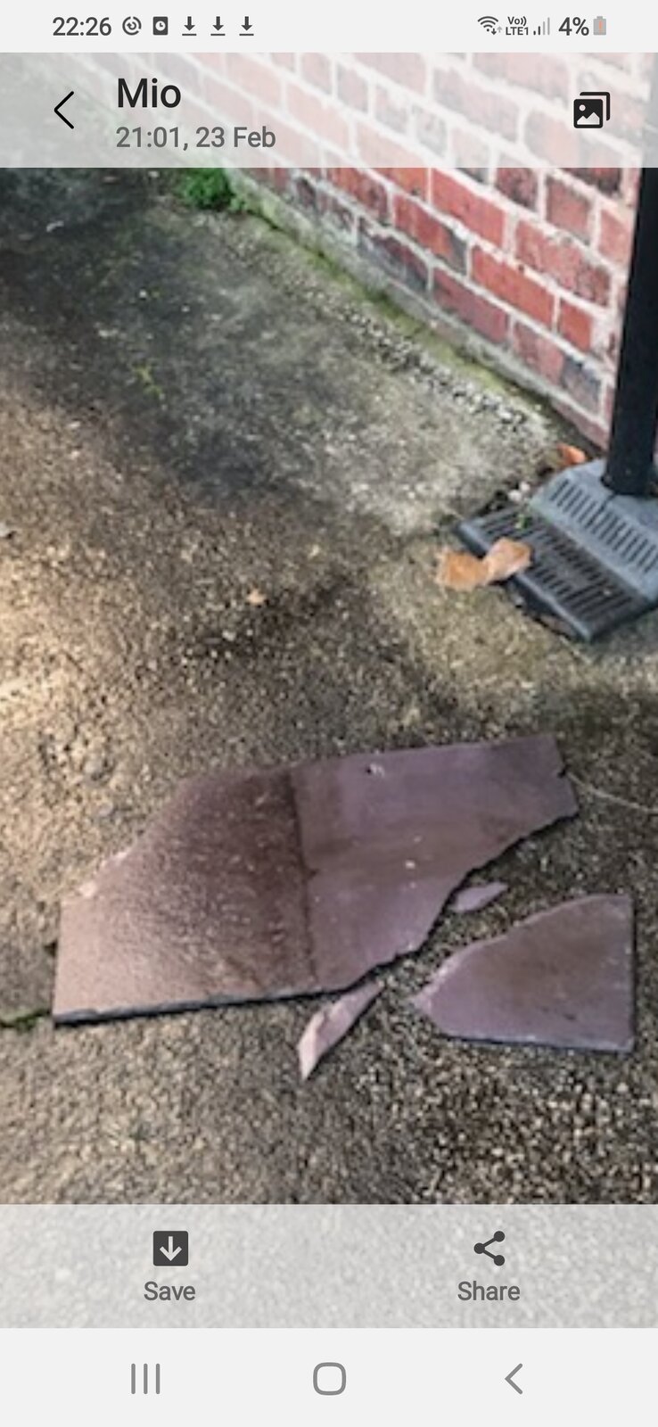

Can I buy and replace a cracked roof tile?
11 Oct 2016
902
13
I'm not sure where I can buy roof slates?
If I get them would I need to cut to size?
Is it better to just get a roofer to do it?
It's only a ground floor annex, these things fall off from time to time so it may be a good skill to learn.
Thanks for any help you can give me

Looks like a 20x10 . (500 x 250) most roofing merchants will have some but usually Spanish. This is a Welsh slate , Penryn probably best bet reclamation yard.

DIYer. Replaced a few on the Front Door Canopy.
A fairly common sense job.
I bought some reclaimed ones from here in Ashton. Think they were £1.50 each a few Years ago
Take one with you for size/colour
https://roofslates.com/
Lots of Guides on Youtube for replacing individual Slates
Have a look at Slate Hooks
I got a Slate Ripper from Tool Station.
