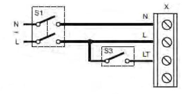

Hi All,
I bought an Airflow AV125 fan (or at least I thought I did) but when I came to install it at the weekend I discovered its an AV125T fan (which has an integral timer).
The problem is that I have also bought a humidistat to fit in the bathroom because we have a damp issue (mould stains on sloping ceiling) and I thought that would be the right way to go.
I was just wondering whether anyone could advise if it was possible to wire the AV125T up so as to bypass the timer and control it by the humidistat instead?
Advice greatly appreciated.
Thanks.
Dan.

You can turn the timer fan into a non-timer by just connecting together the L & LT terminals. But I would recommend you use the fan in timer mode plus the humidistat as a second LT input.

Sorry about the pic - hopefully that's corrected now. javascript:emoticon(':oops:')

As things stand I've got the Airflow AV125T fan and the Airflow Electrical Humidistat (http://www.alertelectrical.com/prod/3934/airflow-electrical-humidistat-30-to-90).
My thinking was that the timer and humidistat would conflict as means of control (ie. the timer might turn the fan off before the humidity has reuced?) but if there is a way of wiring the two together then I'd be grateful for the suggestion.

I would need to see the wiring diagram to see if you have even purchased the correct controller as you do not have a 3-phase fan nor a contactor.
Normally you would wire the fan as per that drawing in your post but the switched live output from the humidity controller would connect to the LT terminal. Then the fan will come on when the humidity is too great. When the humidity reduces, the fan will run on for a while (re the timer)_.
