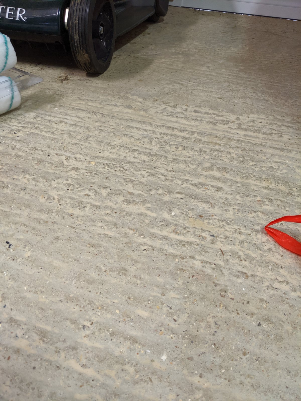

Hello,
I am planning to make a home gym in my garage. The floor is concrete, not smooth (picture attached). I was wondering if I can just stick carpet tiles over the top or maybe a carpet underlay, then carpet tiles on top.
Hoping to avoid screed/latex.
Cheers

To create a workshop/utility room we laid a full polythene sheet for a DPM, then laid the cheapest laminate flooring on top of its suitable underlay. The original concrete has DPM but no insulation, the room is unheated & does suffer a little condensation but over the past 8+yrs the laminate has only sufferred minor damp penetration to the joins.

I probably have a dpm, it's an attached garage and the house is just over a year old.
As a very rough guide you could try laying a sheet of plastic down and weight the edges to keep it in place to see if any moisture builds up on the underside.
Why don’t you want a latex screed ?
I have a few things in the garage which will require dismantling to get them out, it will be a real pain so hoping to avoid it, would be easier to do one side/move the things/do the other side.
if the concrete surface is reasonably smooth then just lay whatever you chose on the bare concrete.
