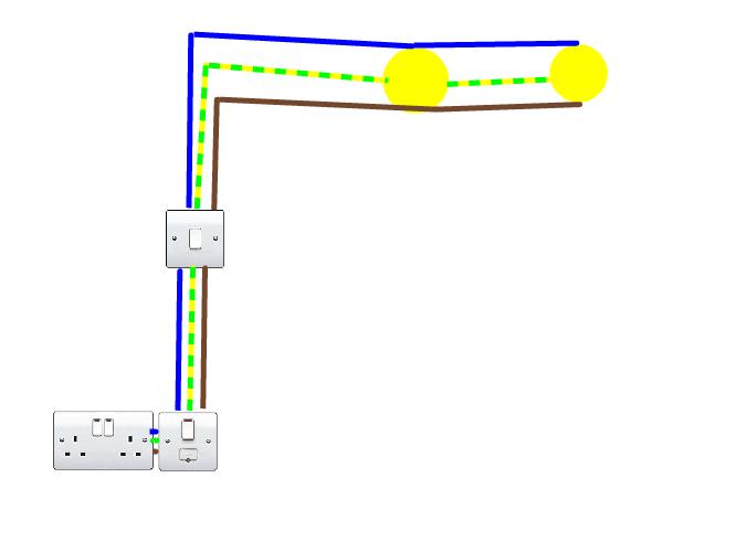

Hi,
We had a small extension built on the side of the house a few years ago. At the time, we never bothered having any lights installed on the ceiling inside. It is quite dark in that area of the house. I was wondering if it is possible to connect a light switch to a nearby double plug socket so that we can install a couple of inset spot lights in the the ceiling to make it a bit lighter?

You can.
The best method would be by using a fused connection unit from the socket outlet, down fusing to 3A. Then running the cable for the lighting circuit from there to switch then to lights.
If the cables are buried in the wall less than 50mm, then mechanical protection of the cable or RCD protection of the extend circuit will be required, if not already offered to that circuit elsewhere.

something like this
Brown= live
Blue= neutral
Green/Yellow= earth
The blues at the switch connect together using a connection strip, as this is not required to be terminated to the switch plate.
The brown at switch connect the feed from the fused spur to com and the load side to light at L1.
The diagram shows a switched FCU, but this can be unswitched.
So, if I am right PrenticeBoyofDerry, I would get an unswitched 13Amp connection unit and place it close to the double plug socket so that it is out of view. Could I then wire this up to a single dimmer switch in the extension area and connect inset downlighters in the ceiling?
Place the fused connection unit as close to socket as possible, it can be hidden but must be accessible for inspection/testing and maintenance.
Then as diagram the switch can be a dimmer. When choosing the dimmer and lamps(bulbs) you must use dimmable lamps and make sure the load rating of the dimmer is suitable for the load of the lamps.
Also you must route the cables in permitted safe zones.
