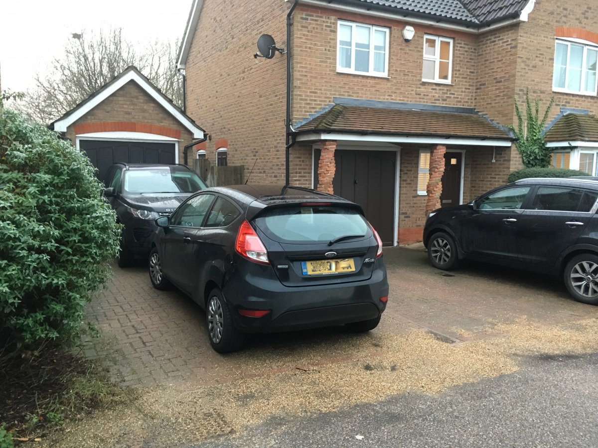

They are referring to Essex parking standards guidelines which state sizes parking spaces are recommended to be and they say because parking is a problem in my area they have to enforce it in my case because I will take a space away by converting the garage, (not that we have ever put a car in the garage the last 15 years) the outside spaces that have always been there, although I currently fit a Land Rover and a fiesta on them, aren't adequate because in the future someone with two larger vehicles might buy the house then their vehicles wouldn't fit on..

It was built in 2000 with a clause that the garage should be only used for parking but the council have said they aren't enforcing that as they encourage development. However my drive I park 2 cars on isn't long enough for 2 cars in their opinion and could be "unsafe". When I look at it these same size restrictions mean the existing garage isn't big enough to be a garage as it's under 3M wide even though on the deeds it's a garage. So which presides, the "garage" from when it was built or what's defined as a "garage" by Essex parking standards?
If they are classing the garage as a parking space, then logically a "garage sized" space on the front garden is a suitable space too, and wont be a loss of a space if the garage was lost. So that would be worth appealling against.

Thanks for the 'photo. Looks like the house was built with an included garage and second parking place outside of that. From your comments it reads to me that the council are applying the later standards to your request than when the external garage was built - which just seems to be a 'jobsworth' being pedantic (and >probably< wrong).
