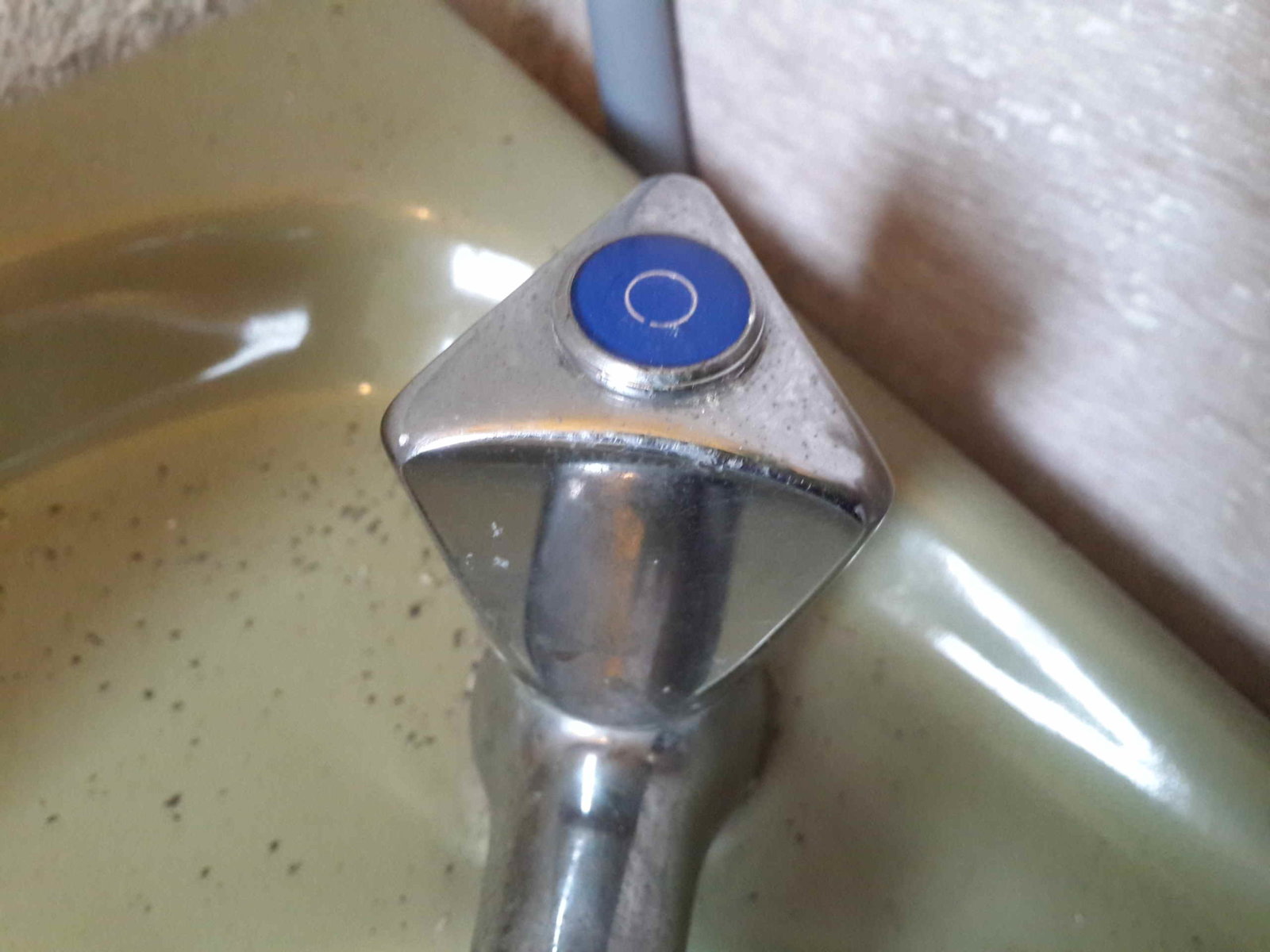

Can I fit a tap reviver kit to these taps?
9 Apr 2012
278
3

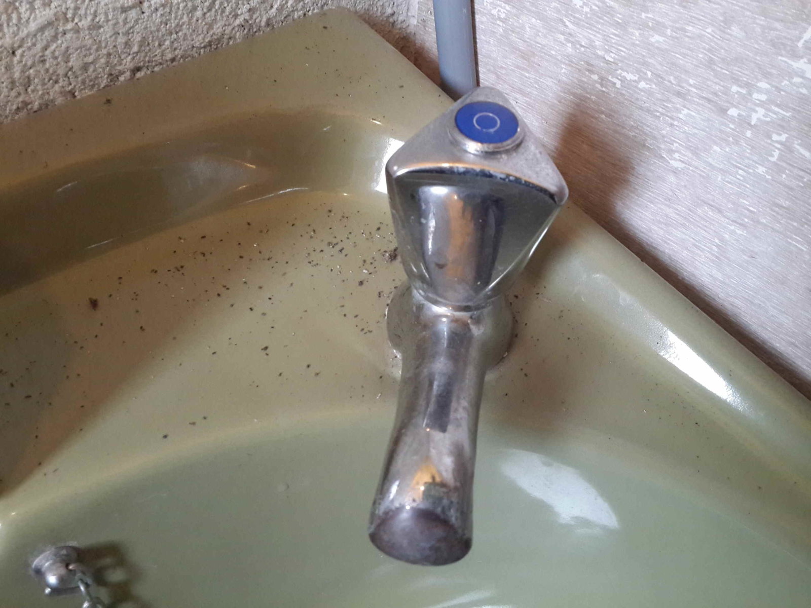

Taps in photo were fitted a long time ago, how long before 2007 I don't know.
Hot tap hardly turns and is tight.
So I got a tap reviver kit from Screwfix, see photo.

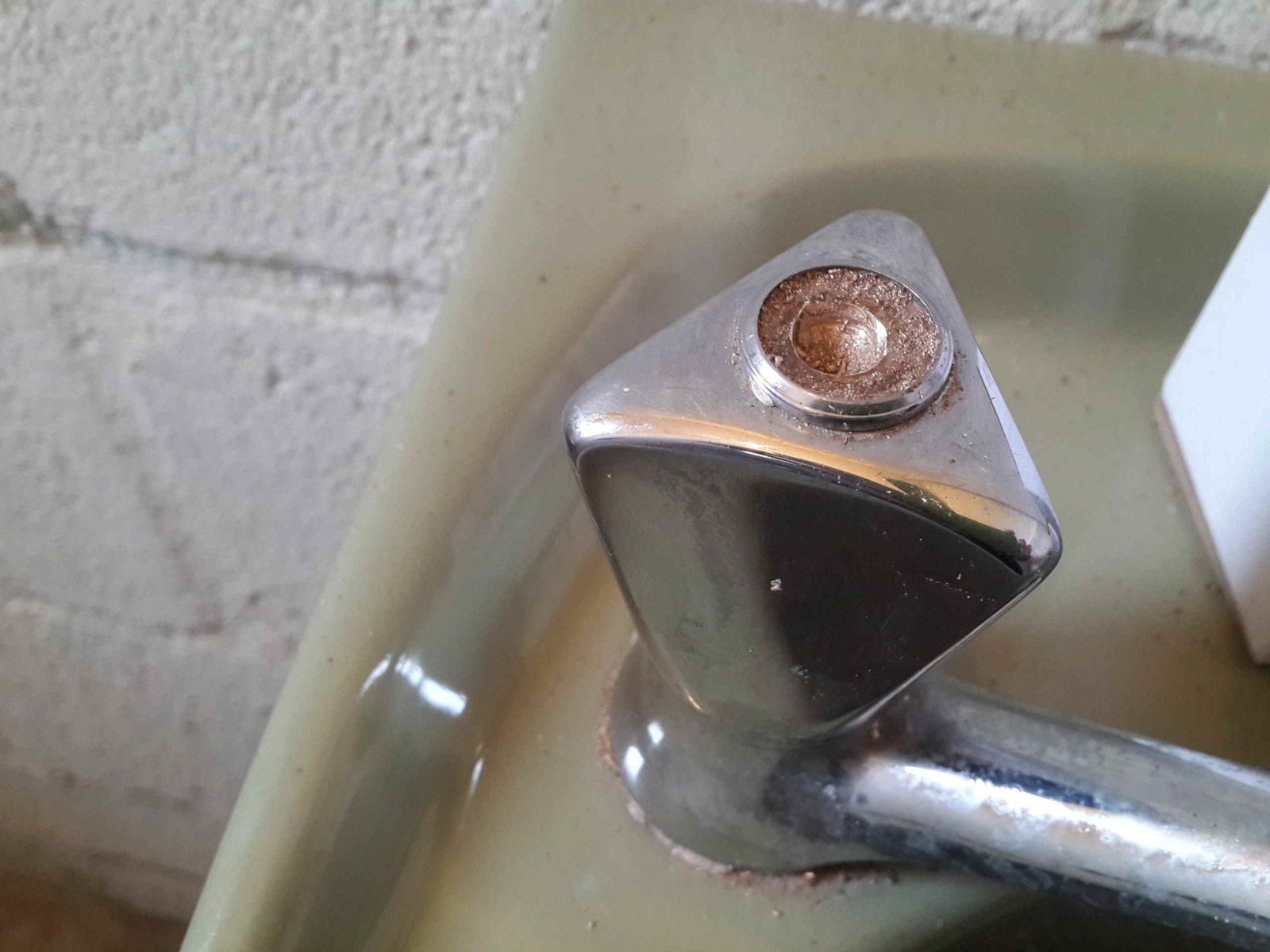

However I can't pop the cap on top of the tap to release the screw.
I drilled down a bit, see photo, and top of tap still not released, so I stopped.
No screw appeared under the red hot cap on top of the tap as I started drilling.
Anyone know; will I be able to use tap reviver kit here and if so how?
Use a pair of pliars on the small chrome rings and they should unscrew, cant see why not you cant use the 1/2 tap revivers.
Thanks @picasso. That did it. It got the taps tops off.
