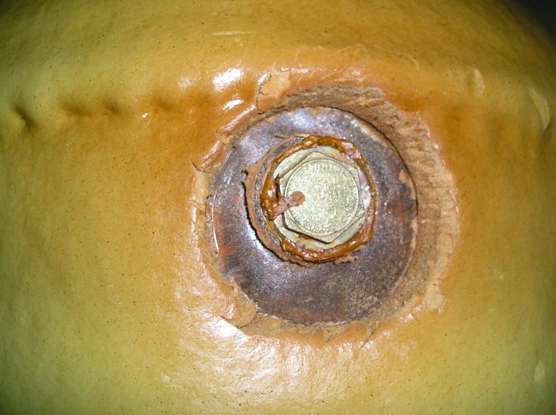

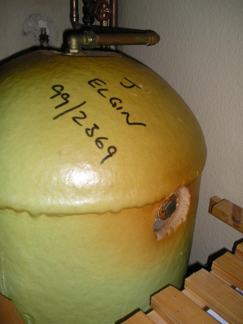

Although I am quite experienced in plumbing, as a DIYer, I am about to install a power shower for the first time. It is an Aqualisa pumped shower, that permits installation of the (supplied) dual pump in the loft (provided that its below the bottom of the CW storage tank). Having read through all the archives here, it appears that an Essex flange is the best method of drawing off the hot water from the DHW cylinder. My cylinder has a blanked-off hole in, what I believe to be, the ideal place for the flange. The cylinder is indirectly heated and the heating coil is on the opposite side. I have supplied 2 photos. My questions are:
1. Is this blanked off aperture simply a hole that a flange can be fitted on to, or is there a spare heating coil behind it?
2. Is this an Essex flange? If not, what size flange should I order (I will be using 22mm pipes up to the loft). In either case, what other connectors would I need?
Many thanks.
Kev
It`s a secondary circuit return tapping ..1" BSP . Nothing behind it . I would get a 1" x22mm compression MIron/copper fitting . Then with a file or a Dremel take out the pipe stop so that the copper pipe goes through into the void , that will a void :rolleyes: any air bubbles entering the pipe as they klingon to the sides of the cylinder ;)

Good point from a previous poster about air bubbles rising at the side of the cylinder, could you just not fit a 'surrey' flange? It comes with a dip-tube to prevent air bubbles entering the showers draw off pipework.

some aqualisa pumped showers (hiqu etc) will allow a hot water tapping directly from the domestic hot water pipe on top of the cylinder. Ive fitted one in this position without any hot water draw off problems. This will obviously avoid having to tart around fitting a flange. alhtough check the install instructions
You got a 1" bsp sec. return tapping, You will have a 1" Bsp top tapping ;) . You can use the vent as a draw off but it has to rise @ 45 degrees and the take off tee hangs down underneath ( again for air bubbles- Not as bad as bubbles in a hypo. ;) )
