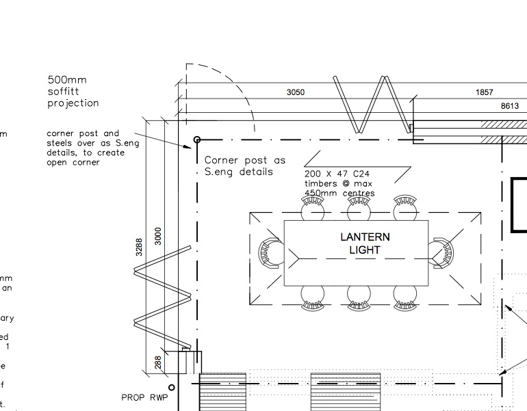

I'm having a rear extension built and the intention is to have bi-fold doors at the corner that create an 'open corner', with minimal structure blocking the view (apart from a 100x100mm square section corner post).
The steel frame and corner post have been built, and the corner post has been set to the inner skin of the cavity wall.

Did you have a set of construction drawings produced showing the relationship of the wall, glazing and column?
Unfortunately not. The architect was vague with that detail, leaving it to the structural engineer to design the steels. And the structural engineer just provided hand-drawn sketches calcs and steel details, with no reference to the glazing.

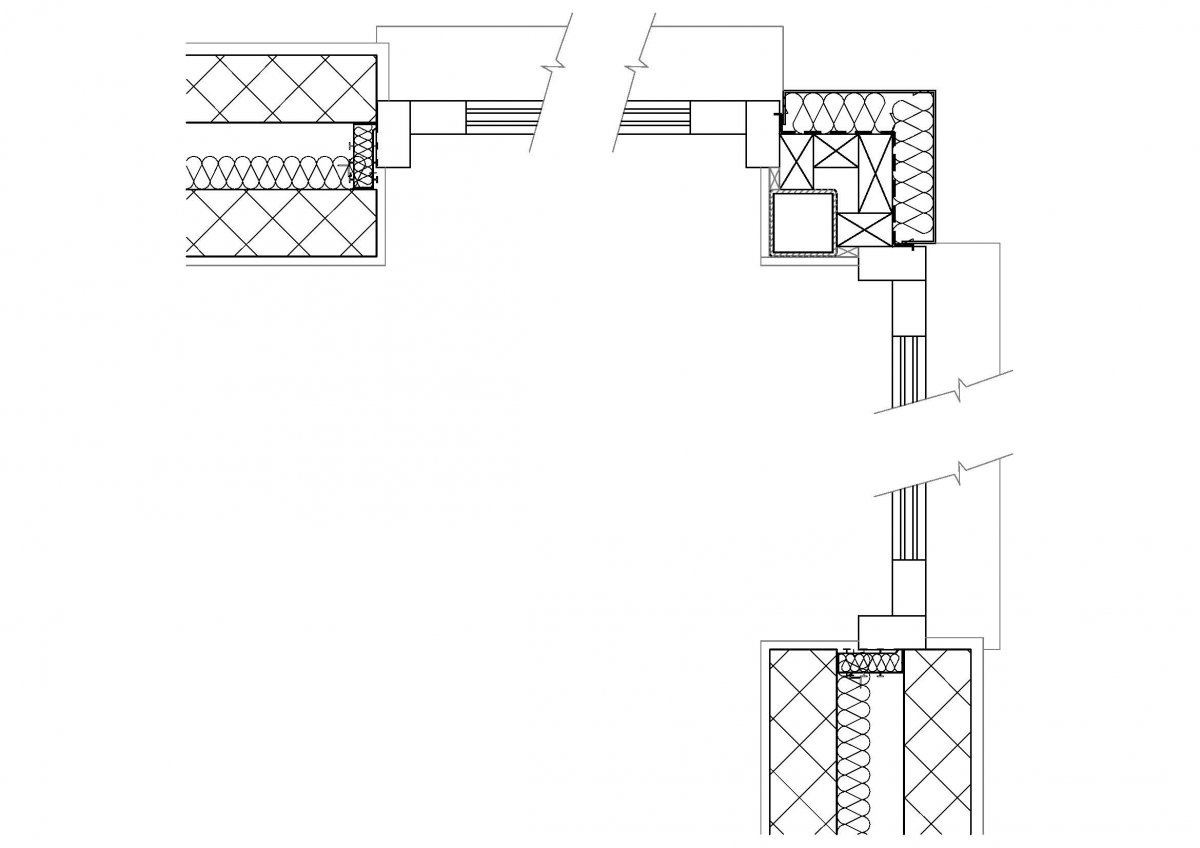

I think this is about the best you could achieve without moving the steel:
Your architect should have done a detail for this corner and ensured that the column was offset, assuming he was responsible for liaising with and checking the engineers drawings and avoided this predictable error.

If none of this works, then your drawing is pretty much exactly what I'll have to do. It's not a bad option, but I'll fully exhaust the minimal corner post option first. (cheers for the drawing!). Attached is the detail my architect gave me. It's pretty vague, but you can see it sites the corner post on the inner skin and my structural engineer has blindly followed this - I didn't pick up on it so I didn't stand a chance!
