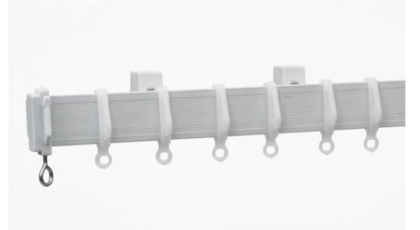

I live in a rented flat without curtains which I would like to install before winter to keep heat in at night. My rental agreement precludes drilling holes into the walls. I am considering buying plastic curtain tracks (not rods) for medium weight curtains which will be very close to the walls and I'll sew Velcro to the sides. Is it realistic to use No More Nails adhesive to fix the tracks to my painted brick & plaster walls?

No more nails will bugger a wall way more than a couple of screws.
There are telescopic poles that will take a decent weight.
However telescopic (no matter how good) won’t hold much compared to screws.

Put a spring loaded shower rail inside window reveal.
That will probably mark walls over time.
Curtains with the tugging won't be supported with anything like sticky velcro and glueing will only stick to the the paint, so if the glue don't fail the paint will and come off.
It's a drill for the rail with decent fixing especially at the ends.

curtain tracks aren’t fitted directly, usually a timber batten is screwed up first.
You can get no drill telescopic poles, but reviews are mixed.
