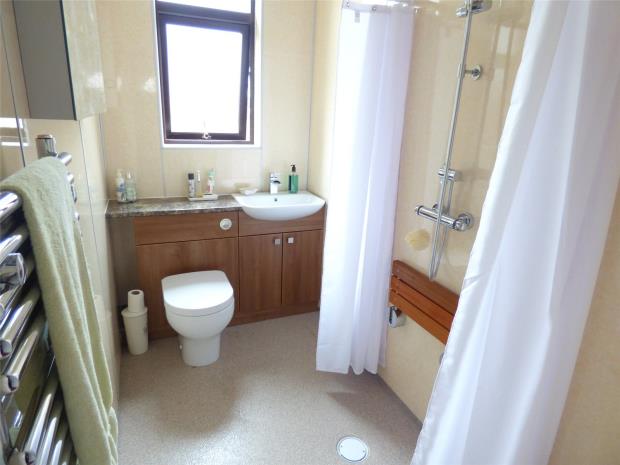

Hello,
I recently moved into a 1930's terraced house. The house was dated so I've been busy upgrading it all. It was owned by an elderly lady who had a wet room installed 6 months before I bought it. The only downsides are a cheap looking shower curtain rail and heavy duty vinyl flooring. I can live with the flooring but the shower curtains do not stop water getting to the rest of the room and I'm fed up mopping every morning after a shower. Is it possible to fit just a shower enclosure without a tray?

Yes BUT the fixings to the floor may compromise the floor and create the potential for leaks. The leaks may take some time ( months ) to develop depending on how fleicible the floor is and how rigid the shower cubicle frame is. ( or the other way, rigid floor and flexible cubicle frame )
Using shower curtains that reach the floor and have weights in the bottom hem will significantly reduce the amount of water that "escapes" from the shower area. ( as in my cubicle free shower )

Most require just a fixing into the wall and just silicone seal on the floor.
A decent curtain would be cheaper than a cubicle, unless you happen to have a cubicle in stock...
Don't quite understand the problem, is the waste outside the curtained-off area? If so, you could - maybe - move the shower apparatus to be nearer to it.
Post a picture, and show the direction the water goes. If the waste is inside the intended area, then the next question would be, will the water stay within the partitioned area.
Each cubicle partition will be installed differentlym but most will have a channel siliconed to the floor, and fixing to the wall. Some will then be fixed to the ceiling for support, and others to an adjoining panel, but none should compromise the integrity of the floor, if fitted properly.
