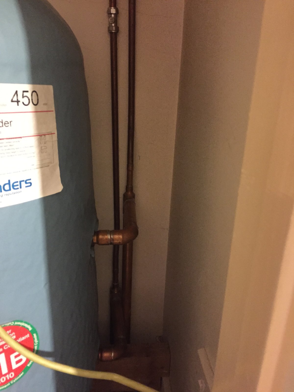

Would someone please advise me on whether this is possible?
My property is a bungalow with an oil fired boiler and gravity fed HW system (I think!) I have removed 2 rads from 2 bedrooms and drained the CH system down (I thought I had isolated the CH feed from the HW as there was an isolator valve coming from the loft tank but this appears to feed the boiler for the hot water too and the system doesn’t have a diverter valve). The CH pipes are buried in the concrete flooring and I am going to be putting in electric underfloor heating in the bedrooms so I cut the copper tails flush with the floor and now I’ve realised that I can’t now reinstate the hot water. So my question is how can I isolate my CH from the HW with this type of system? Thanks in advance.

Thanks,I have recently moved into this property and it hasn’t been updated for many years and it must be, if not the original system, then close to it. This system has a large water tank that feeds the cylinder in the airing cupboard and then there’s a small tank that drops down in 15mm then 28mm into bottom of cylinder then drops to bottom of boiler.

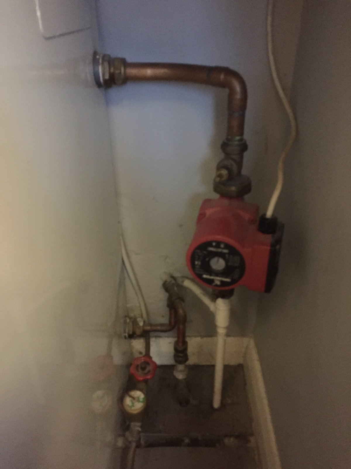

On the opposite side is this configuration of pipes
So how would I disconnect the CH completely for the time being so that I can just have the boiler running the HW? Could I just disconnect the T above the 90 degree elbow and cap that off til I’m ready to reinstate the CH?
just disconnect the pipes at the right hand side of boiler and put a BI plug in the tappings .
Boiler will work on gravity H/w
