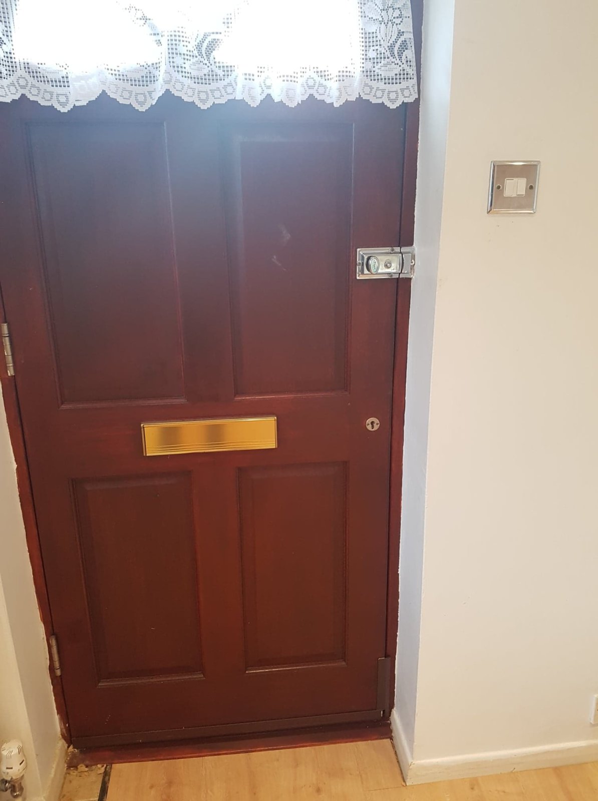

Hi
I have a wooden front door and it has been stained with Sadolin Deep Mahogany Wood Stain. I would like to paint the inside of the door 'white'.
How would I go about this?
I can imagine lots and lots of coats of paint :( Grateful for advice please. front door.jpg
No no simply give the door a sand going with the grain
Prime the door (zinsser bin is good)
Undercoat then topcoat
If you remove the door furniture it makes the job easier

Lovely. Thank you and I've got the Zinsser BIN :)
