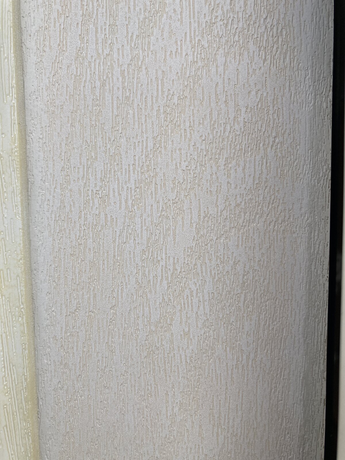

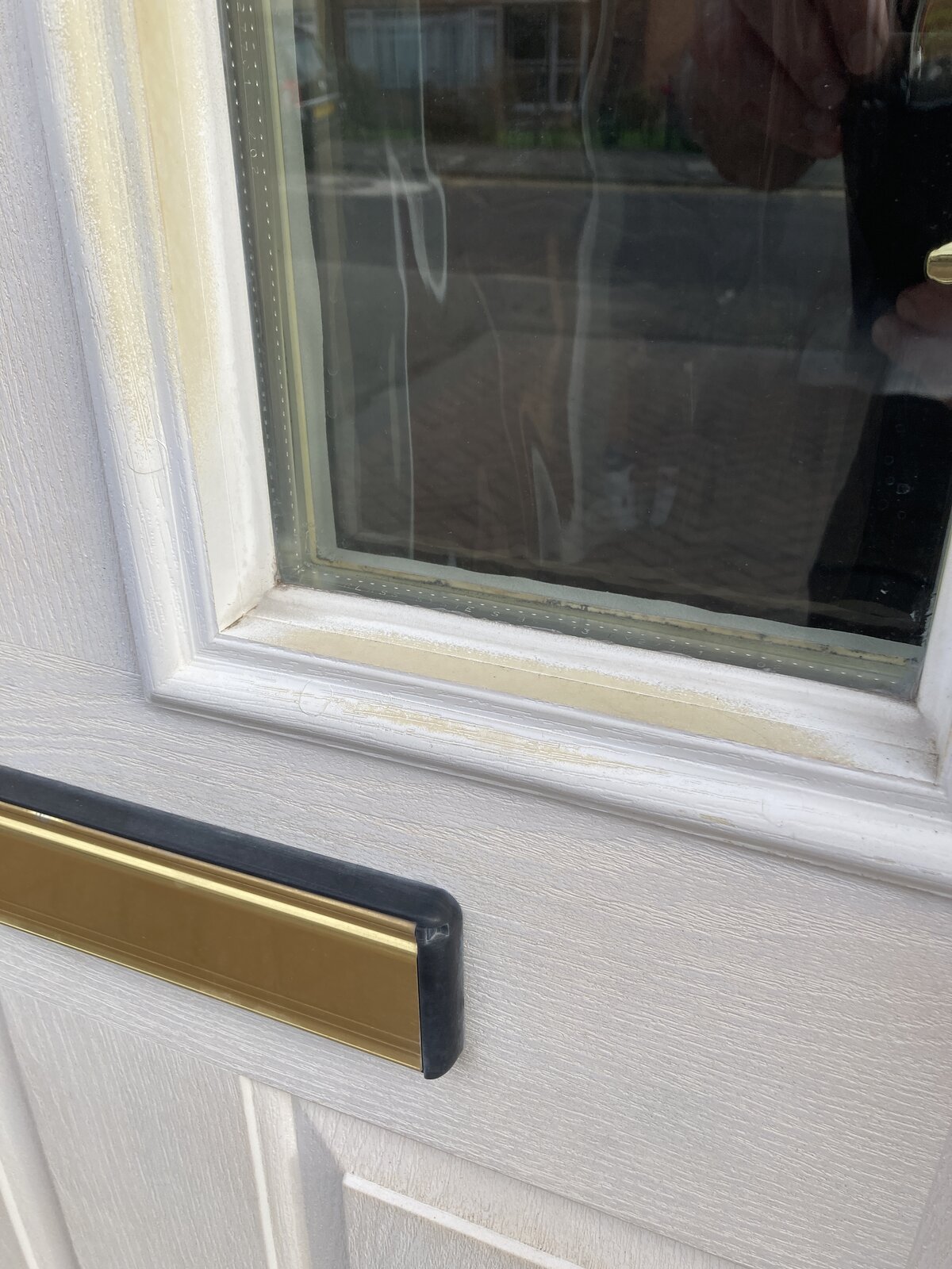

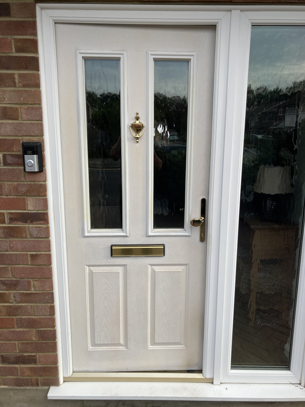

As above. Our front door which has been on for about 15 years now is looking like it needs a new coat of paint - it’s definately a lot yellower than the white frame. I think being south facing, the sun has done its worse. Might even change the colour if it’s possible. Can it be painted and if so, what paint(s) would you recommend? If I could paint it I’d take it off, remove furniture, mask up glass, primer/undercoat (if needed) and spray it.

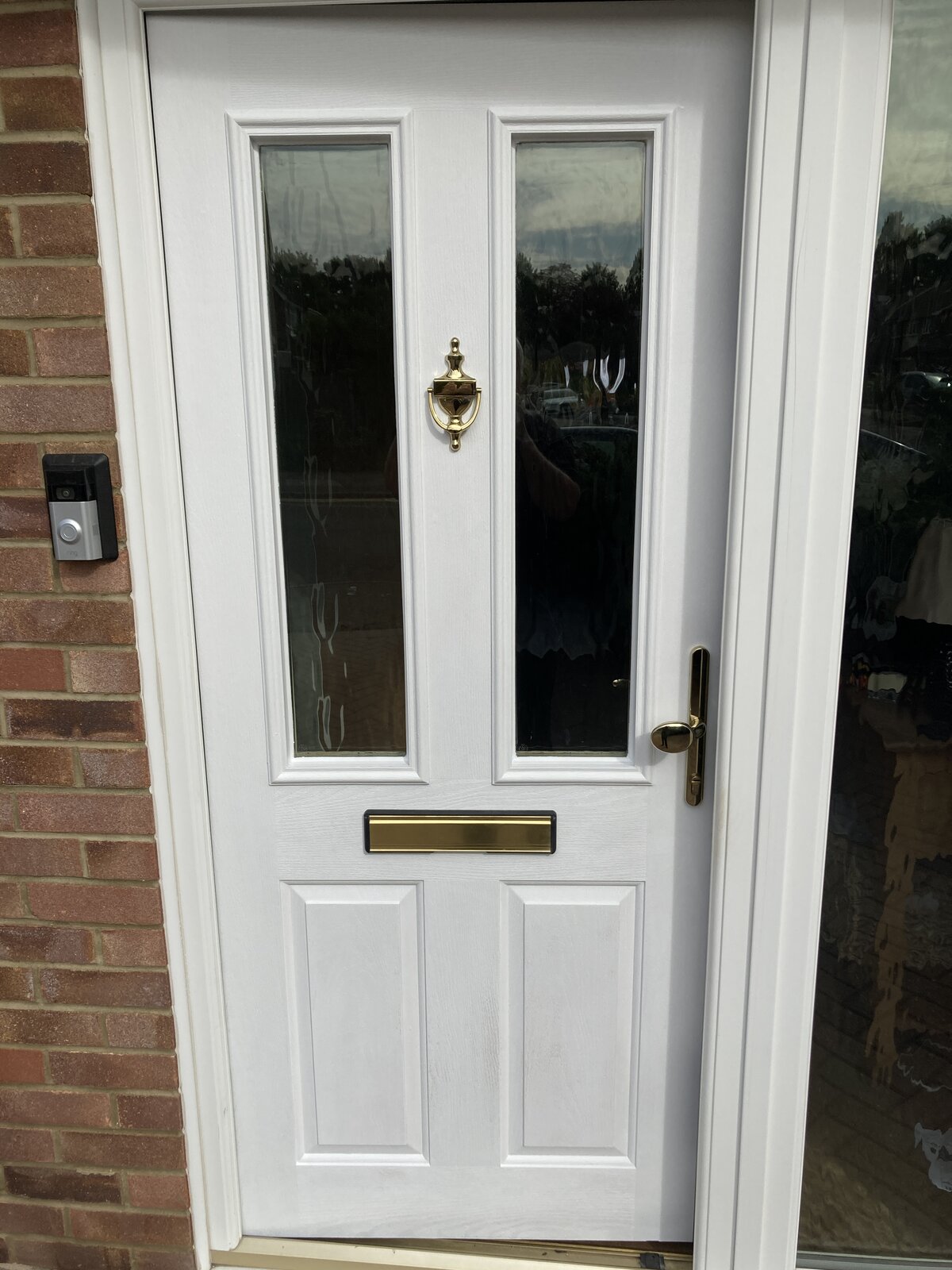

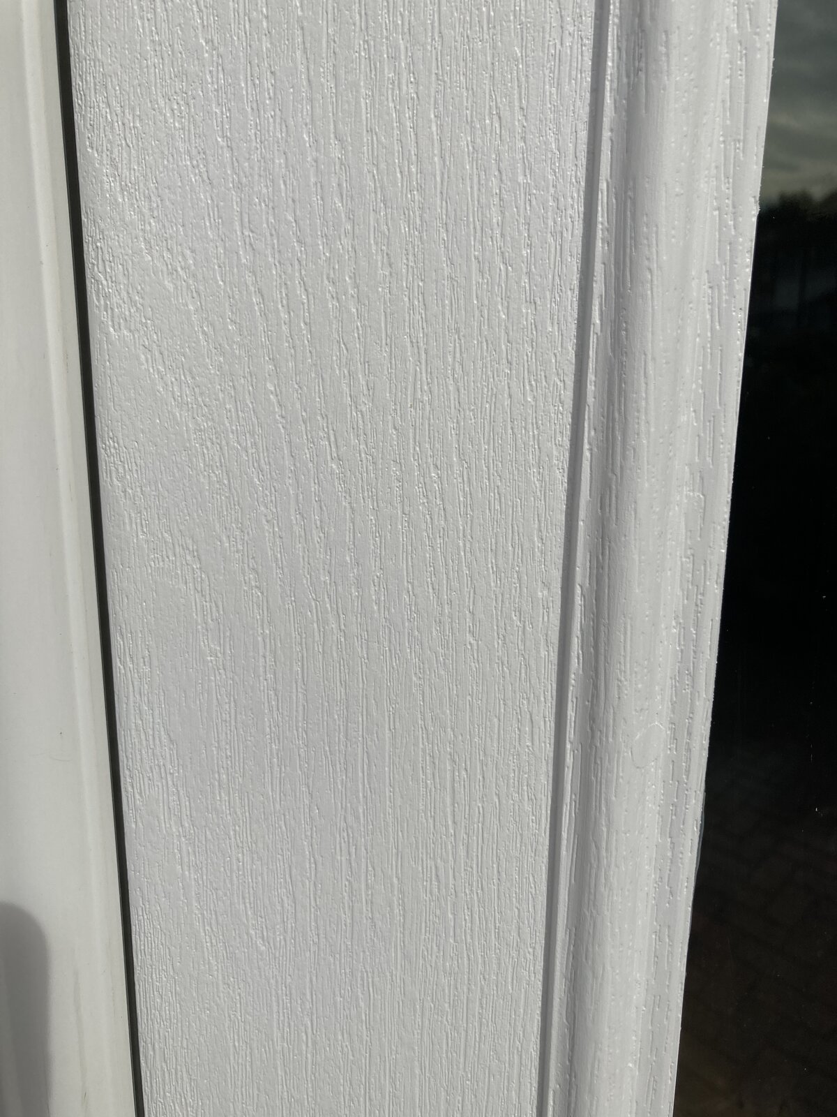

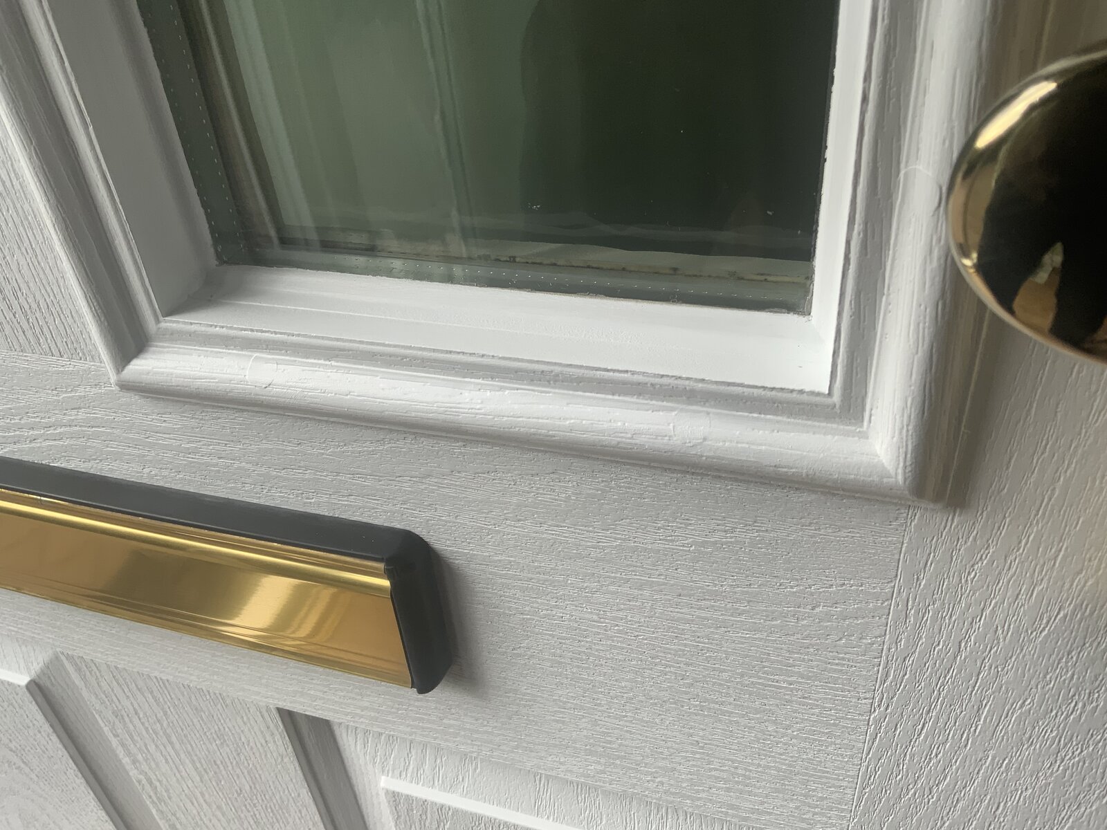

Blimey - my original post was in 2017 - I’m not known for rushing into things! Been thinking long and hard about this. I've just got my lazy arse round to doing it today. I used Frenchic paint. Worked a treat and very easy to put on. I bought a 750ml tin and I could probably do another 5 doors at least!
Before:
After:
