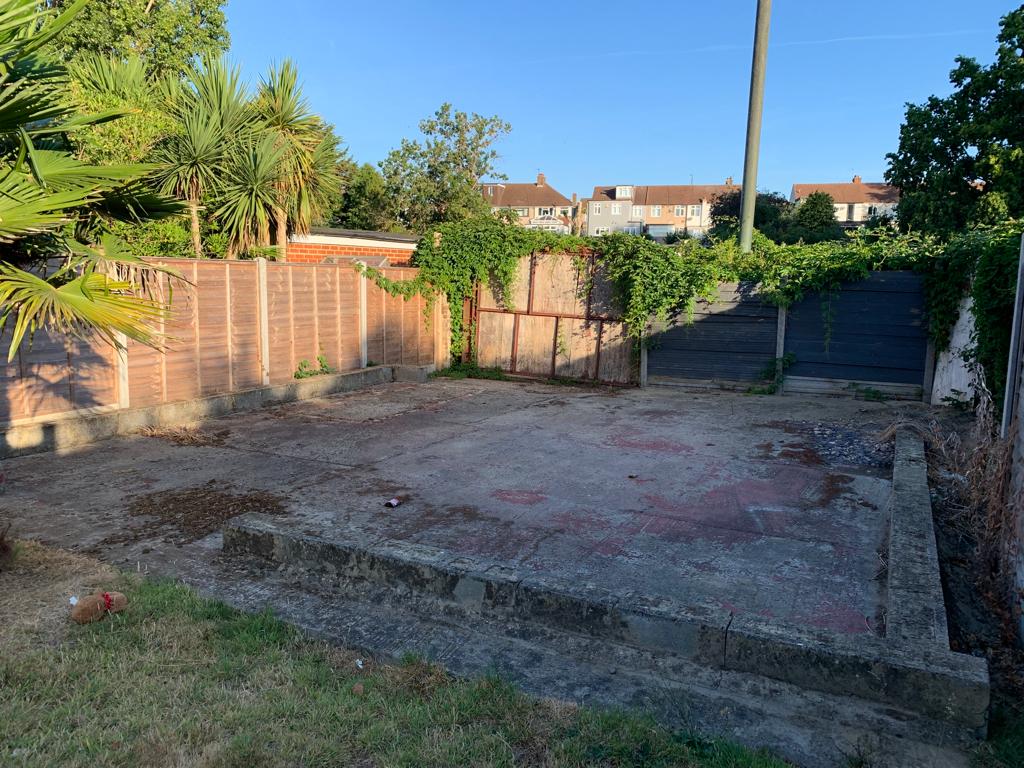

I have lived in my house for 9 years and when I moved in there was a very old but large garage at the end of the garden that was falling to bits so I took it down and planned to rebuild it in the future. I would now like to rebuild the garage but was wondering would I need planning permission and building control if I am just replacing a building that was there before? My neighbours have said they are happy to provide statement that there was a garage there before.
The building would be about 40m2 internally. Photos of site included.

The fact that there was a garage there before is completely irrelevant, in terms of planning law, once a building is demolished it no longer exists so anything built in it's place has to meet the criteria for permitted development or requires planning permission.
Outbuildings are considered to be permitted development, not needing planning permission, subject to the following limits and conditions:
  • No outbuilding on land forward of a wall forming the principal elevation.
  • Outbuildings and garages to be single storey with maximum eaves height of 2.5 metres and maximum overall height of four metres with a dual pitched roof or three metres for any other roof.
  • Maximum height of 2.5 metres in the case of a building, enclosure or container within two metres of a boundary of the curtilage of the dwellinghouse.
  • No verandas, balconies or raised platforms (a platform must not exceed 0.3 metres in height)
  • No more than half the area of land around the "original house"* would be covered by additions or other buildings.
  • In National Parks, the Broads, Areas of Outstanding Natural Beauty and World Heritage Sites the maximum area to be covered by buildings, enclosures, containers and pools more than 20 metres from the house to be limited to 10 square metres.
  • On designated land* buildings, enclosures, containers and pools at the side of properties will require planning permission.
  • Within the curtilage of listed buildings any outbuilding will require planning permission.
*The term "original house" means the house as it was first built or as it stood on 1 July 1948 (if it was built before that date). Although you may not have built an extension to the house, a previous owner may have done so.
*Designated land includes national parks and the Broads, Areas of Outstanding Natural Beauty, conservation areas and World Heritage Sites.
So if you wanted to build anything not in accordance with the above (eg 5m tall) then you would need planning permission.
At 40m2 it would also be subject to Building Regulations Approval. https://www.planningportal.co.uk/pe...egulations-approval-needed-for-an-outbuilding
