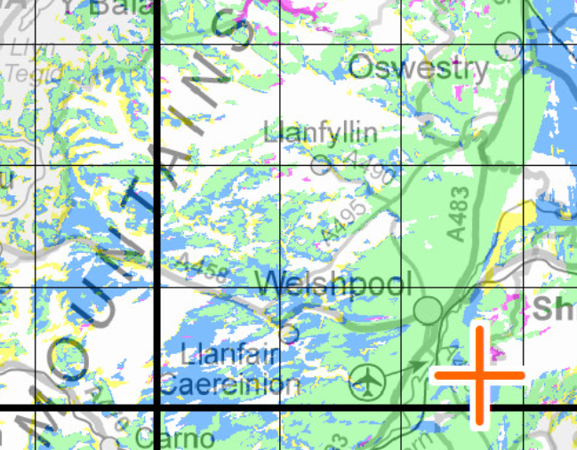

I now live in Llanfair Caereinion, the coverage map seems to show I have very little chance of getting a standard broadcast receiver to work, some where I have a world wide receiver complete with a beat frequency oscillator, which may work, but I want radio 4 or radio 2 not some obscure transmission, MW and FM both seem to have nothing.
I don't want to be powering a monitor or TV to just listen to radio, yes I can get Radio 4 on my PC, but that's same as using TV I have a screen powered up and running.
So what are my options? I have considered cutting a bit of 300Ω ribbon cable and making a slim jim or J beam, but I can't remember how to tune them in and with no signal to start with it would need to be right first cut, can't trim it in as don't know if I even have a signal.
So any ideas? I have passed my RAE so have a back ground knowledge of radio, but not sure how to get any radios to work when starting with no signal?

Thanks the Amazon Echo dot seems the way to go, I was going to simply connect the Sky Q box to the audio unit, but found no SCART or Phono outlet on Sky Q so idea did not work out.
I have tried to get Miss Piggy (Moel-y-parc) but not hearing a thing, I am told 70 cm at Newtown but can't get that either, TV seems to be reduced service so assume some repeater some where likely Welshpool, the only radio I can get seems to be the local heritage railway station, no VHF or UHF except for railway and some freeview channels.
I don't think any change of Winter Hill from here, did hope Shrewsbury but nothing heard.
I had just given up, but wife complaining, so Amazon Echo or Nest/Google may be better? should with any look also control lights and heating, I have Energenie and Nest for heating and lights, so seems a good option for Christmas present!
