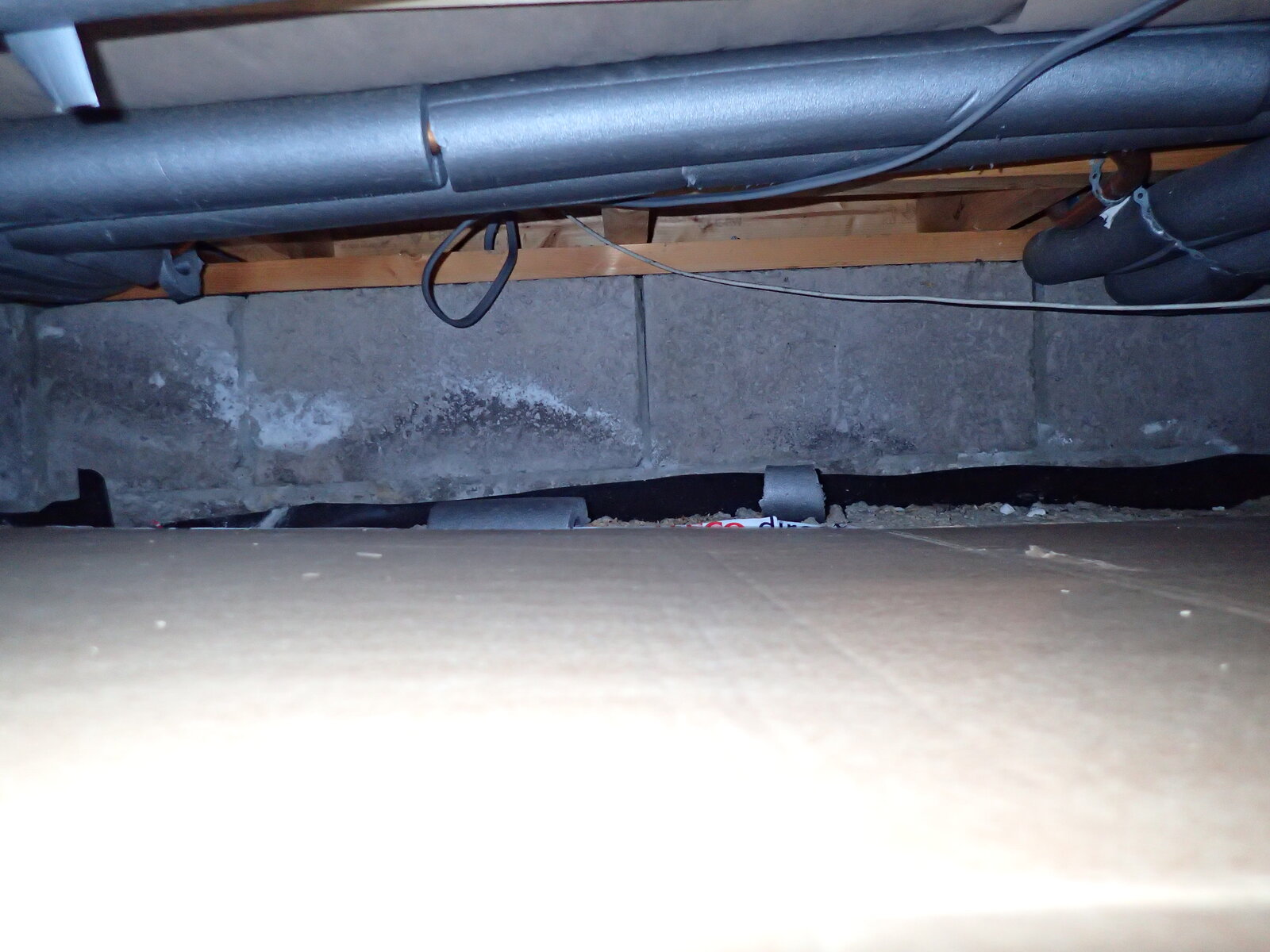

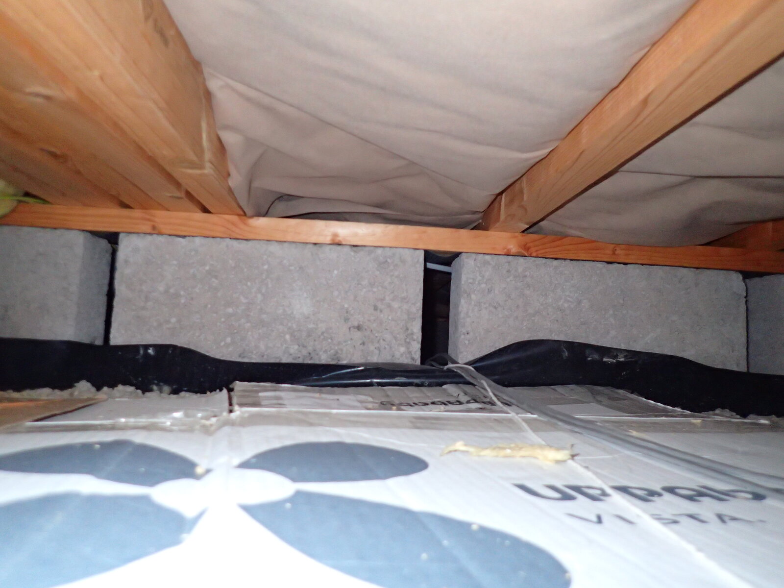

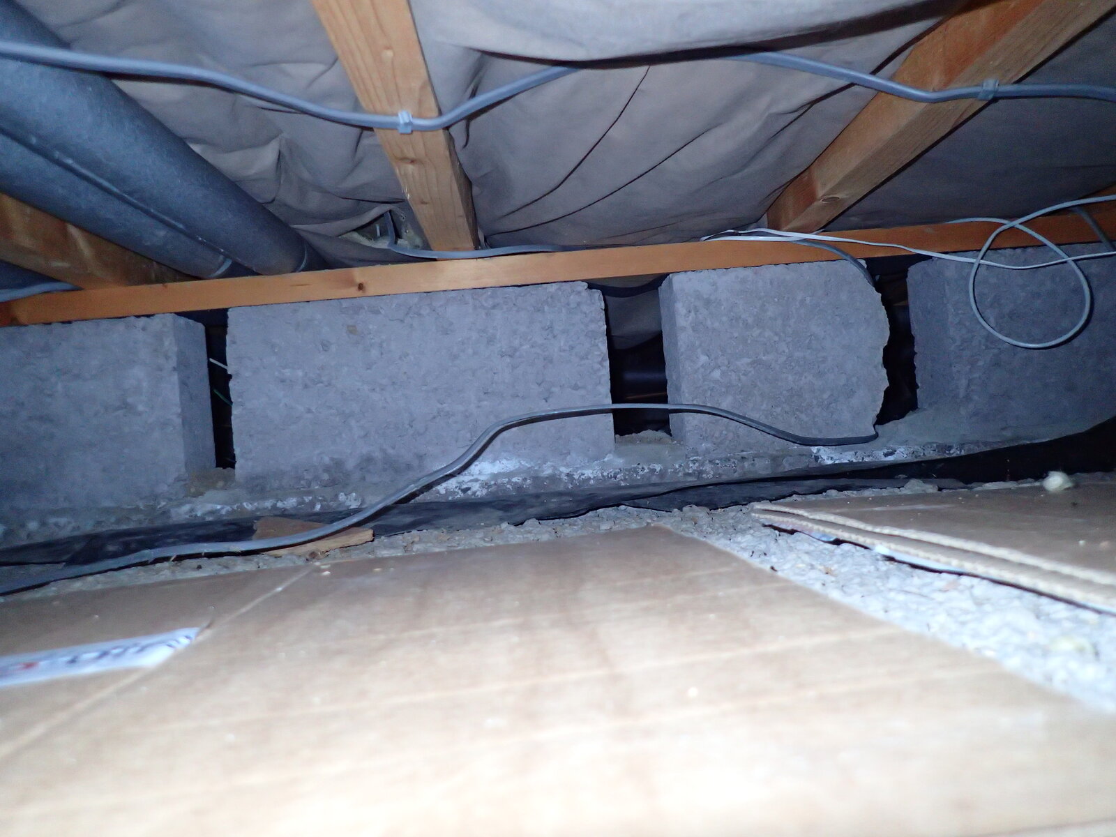

Our has has a one block high crawl space which I can access via a hatch on either side of the house. In the past I have managed to use to draw cables across our house from our router to a home office. However the space under either hatch is very small (about 2m square) and I would like to be able to access other areas of the house.
The sub floor dwarf walls (is that the right name?) are one block high. Under the first hatch it looks like this:
And under the second is this:
Would it be safe to remove one block on either side to allow better access? The 5 wide joist doesn't appear to be bearing any significant load from above but I would obviously avoid the blocks below it, what other advice would you give me in choosing a block to remove? Most of the dwarf walls have either walls or stairs above them.
Going along the house (parallel to the floor joists) rather than across it the walls do not have ventilation spaces. Other than making it harder to remove the wall would this change the feasibility of removing a block?
