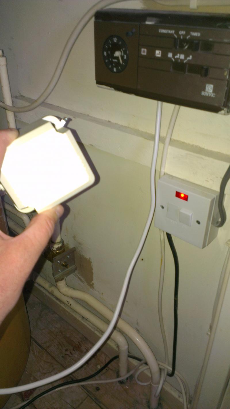

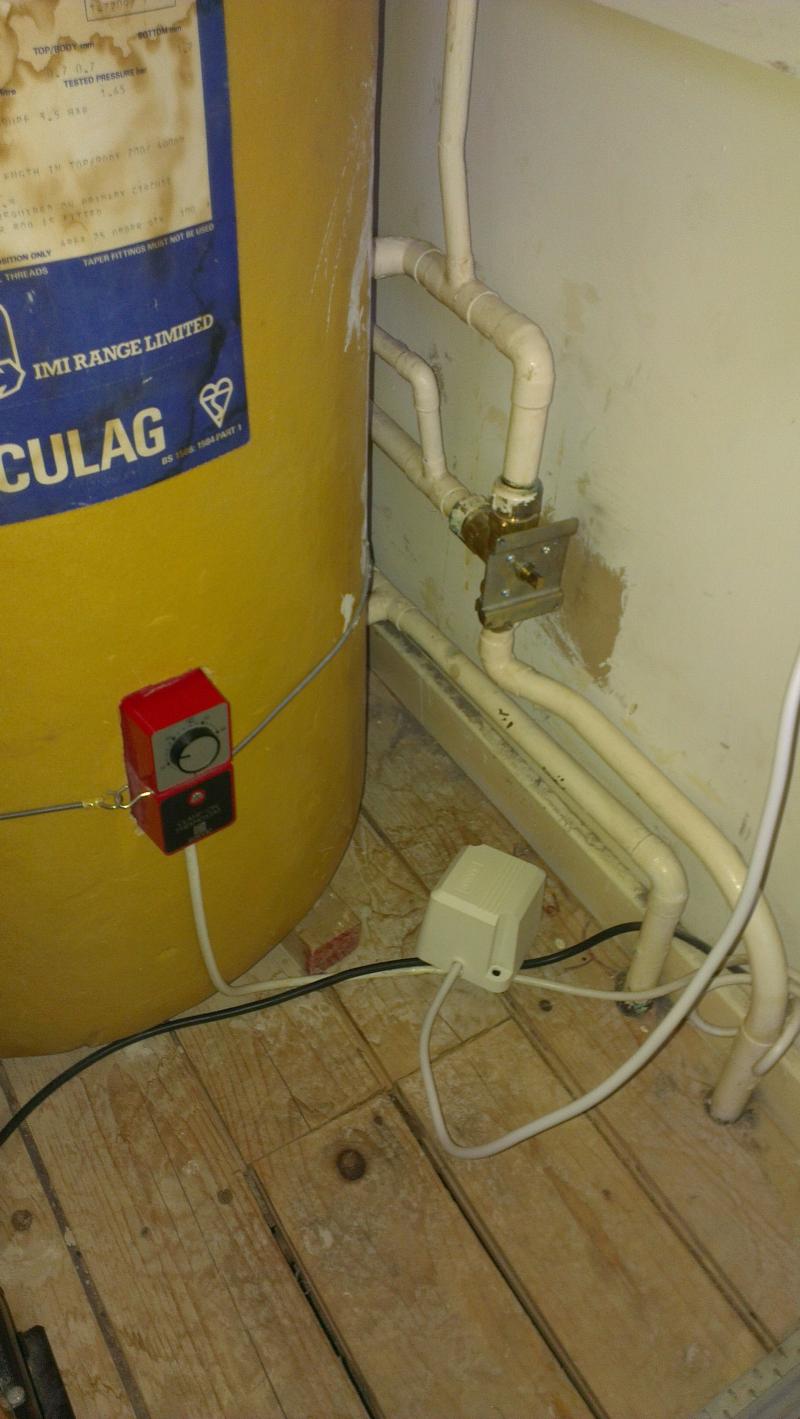

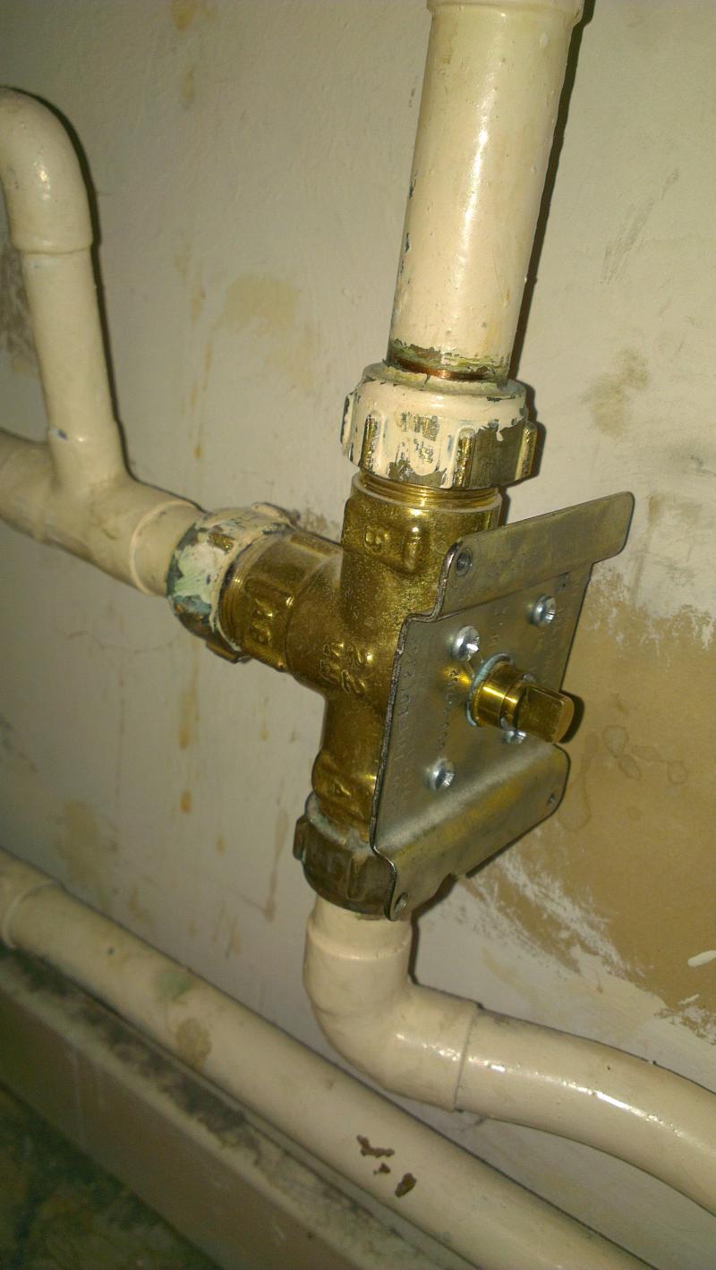

Hi All,
Can I replace a sunvic sdv2211 with a honeywell V4073A or what would the honeywell equalivant be?

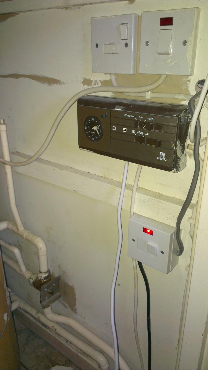

Is it just a matter of draining down the bottom rads, rewiring the new one if the valve is in the upstairs cupboard, I will turn the boiler off and electric as well?
Many thanks in advance.
Gordon :D
Yes you can use the v4073. Drain only enough water to allow you to remove the valve. Body dimensions should be the same, but you may have to change the nuts and olives.

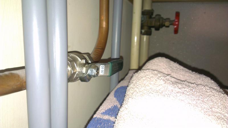

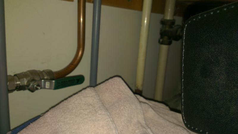

Do those pipes look 22mm?
Would that honeywell model be best for my situation?

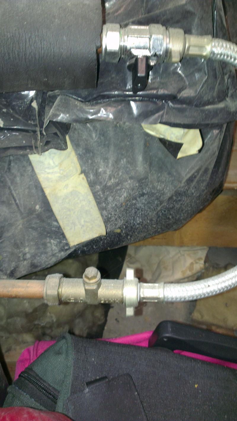

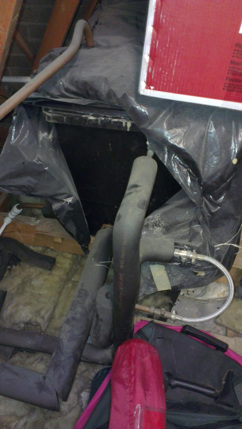

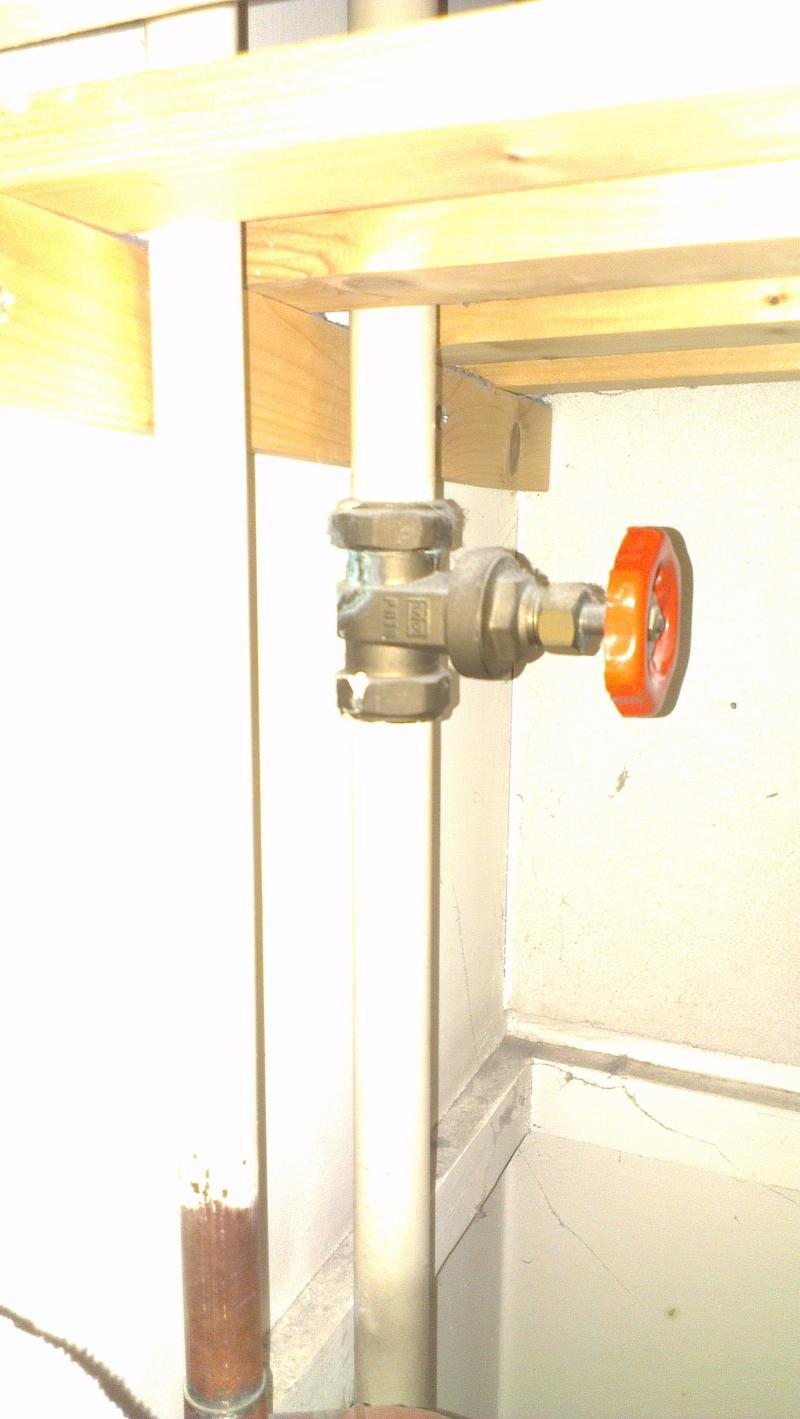

And if I were to put inhibator back in, would that be done in the valve below the cold water feed by the cold water tank?
