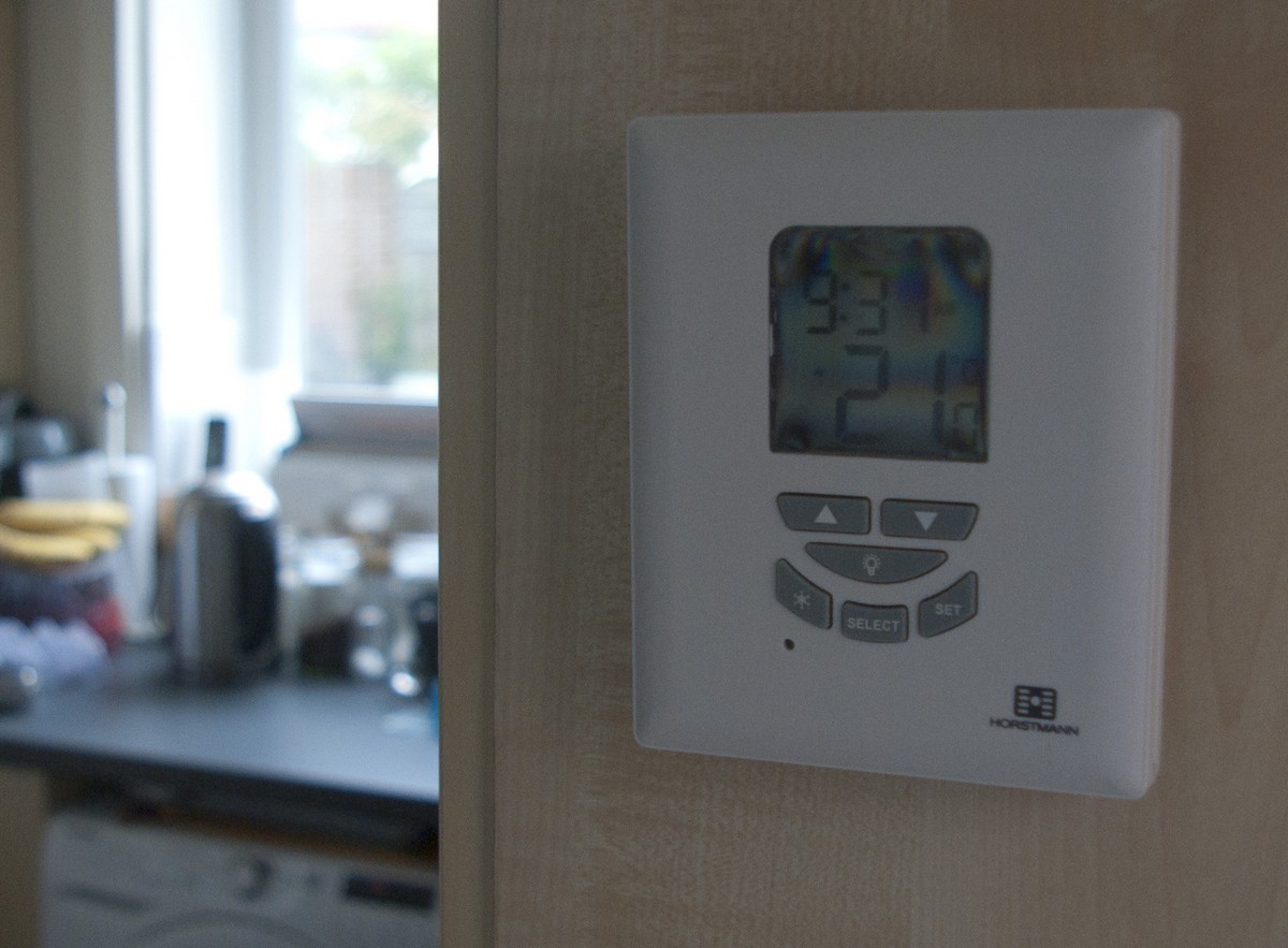

I had a problem with my mother's central heating, this IMGP8037.jpg thermostat slowly got worse and worse, until it would only work when facing the sender. But same house, this
thermostat worked flawless. The other was simply a poor quality thermostat.
As to running wires close to each other, AC will always have some capacitive and inductive linking, but 2 meters should not be a problem, either the low voltage or extra low voltage cable can be screened, but over such a short run, it should not need it, but there are always exceptions.

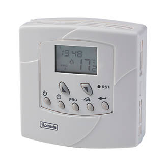

The thermostat I showed
did the reverse, no signal and it turns off, seem to remember using one of these, ae235.jpg and there was an option to select heating or cooling, with heating the normally open contact closed as it cooled, and with cooling the normally open contact closed as it heated, so it would fail safe, when battery went flat.
