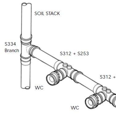

I'm taking a branch off just above an SVP manifold so there is a soil pipe now running in the horizontal plane. I'm wondering if it is permissible to then use a double branch connector (or similar) to allow me to feed in two toilets into this pipe (see attached image)?
If not, how do you normally connect two toilets at the same height into an internal SVP?
what do you mean by a double branch connector, i thought you meant a Y branch to connect 2 pans which are either side of the stack, but if you intend to do it as per the diagram then it will be fine
Hi,
Apologies. I meant the sort of connector shown in the diagram. I wasn't sure if this was allowable under Part H. Cheers!
