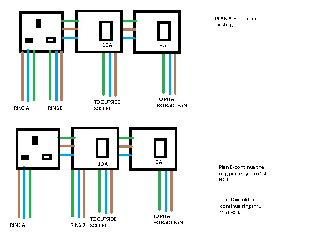

Catchy title and it isn't as shoddy as it sounds- should read 'Can I spur an FCU from an FCU' but it wasn't nearly as catchy
BCO has thrown me a wee curveball- he's just told me I need an extract fan in the utility room as part of other works (because the window was changed 2 years ago- why did I ever take this project on? I must be mad).
Anyway, there is a convenient power supply (ring final) in a double single backbox- 1 x 13A 1g socket and next to it a DP FCU for an outside socket. The DP FCU at the moment is spurred (2.5mm singles) from the 13A socket. Can I spur from that DP FCU to another DP FCU (Plan A to run this poxy 30 litre/second nuisance that'll never get switched on) or do I need to incorporate the first FCU into the ring (Plan B) before I can spur from it? Or is it even better practice to continue the ring through the 2nd FCU (Plan C) Pic attached- ish

Ta for assistance- I've had a quick flick through the onsite guide but it wasn't that helpful. Downside for Plan C is pulling out a lump of Celotex which is rather tightly fitted between studs- very likely I'll have to wreck it to extract it.
Plan A you cannot do. It is a spur from a spur.
There are two options.
Plan B (as you describe) incorporate the FCU for the outside socket into the ring. Then you can spur the new FCU off that.
Plan C connect the new FCU to the LOAD side of the existing FCU. (all your other plans talk about spurs etc on the FEED side of the FCUs….)
Realistically, if you are already limiting the possible current on the outside socket (double?) by way of the 13A fuse in the FCU, adding the tiny load of an extractor fan is extremely unlikely to be risking overloading the spur cable, assuming it's 2.5 sq. mm, unless it's had to be derated by a huge amount.
And aren't the spur regulations from former editions of BS7671 now replaced by mere guidelines and recommendations anyway, so it would still be compliant if that was an issue?
Cheers all- yes has a feeling that Plan A wasn't a goer, Plan B is easy enough to implement so think that's the way forward.

PBC_1966- yeah, think you're right but I'll go for the 'definitely acceptable easy to understand' approach of Plan B. Outside socket is a single, it's there for badness (no specific requirement but always handy to be able to plug something in without having to leave door/window open)
winston1- wasn't sure about the legitimacy of that trick and ramming 4 x 2.5s into the back of the socket is going to be zero fun, think I'll go Plan B (or maybe Plan C if the insulation board will ease out sort of nice like :) )
I have to sympathise with that view. To consider doing things which might compromise safety (like trying to cram 4 conductors into the terminals of a socket) simply so that one could say that one had complied strictly with regulations would seem to be rather flying in the face of the spirit and purpose of those regulations.
