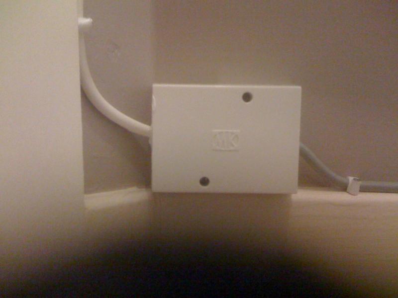

How will you join the two cables?
I was going to use a 30 Amp Ring Circuit Junction Box (3 terminal 250V)
This picture is from my neighbours bathroom
I wouldn't be at all happy with the way your neighbour's spark has carried out the work, least of all if it's in a bathroom.
The best way to extend the flex, if at all possible, is to remove the old flex entirely and wire in a longer length to the heater. If this is not possible, the connection could be made by bringing the factory supplied wiring into a flex outlet plate and making the joint in there. Failing that, an inline connection unit with proper cable strain relief would be the way to go.
Of course, if the radiator is in a bathroom, exactly what and how you can do it will depend on what zone the heater is installed in.

Thanks, thats is how it was before. But ive moved the radiator to other wall. So essentially i need to extend the flex from the radiator by 5meters over the door frame to reach the wall. socket. I cant run the wire in the wall.

if you can't conceal the new wiring you could run a 1.0/1.5/2.5 twin and earth cable from the original outlet in plastic mini trunking to another flex outlet or unswitched fused spur unit next to the towel rail. here you would presumably use a surface mounted patress box. wire the towel rail flex to the new outlet.
t+e is recommended for fixed wiring. don't forget to use earth sleeving on the bare earth wire. perhaps some of this wiring can be hidden in the loft space if there is one.
