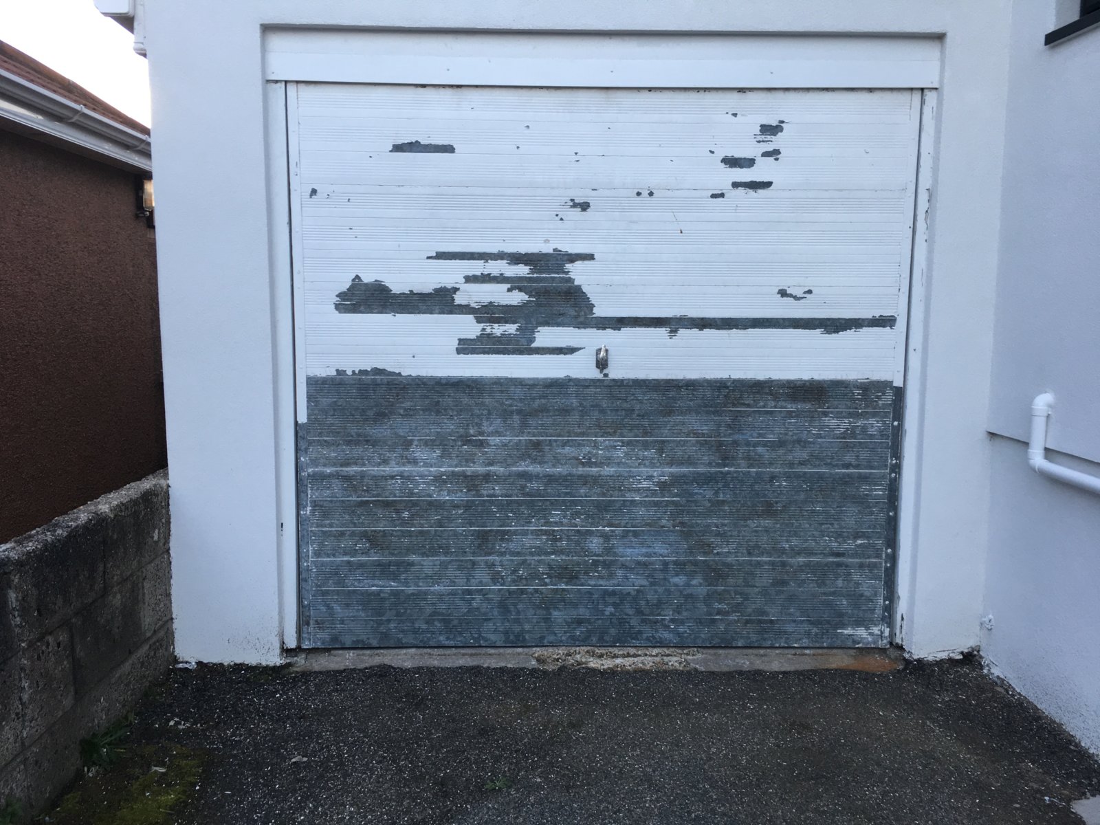

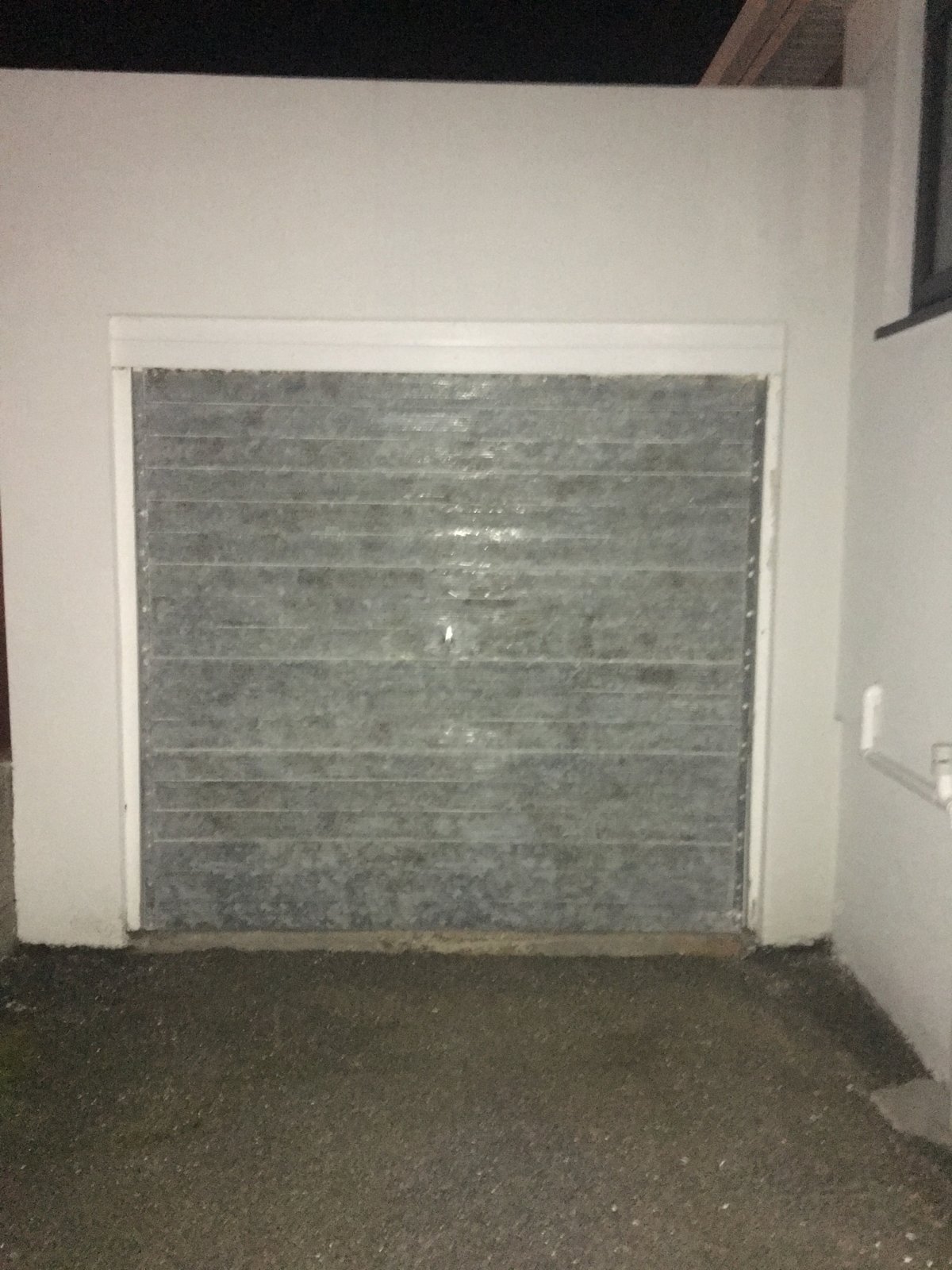

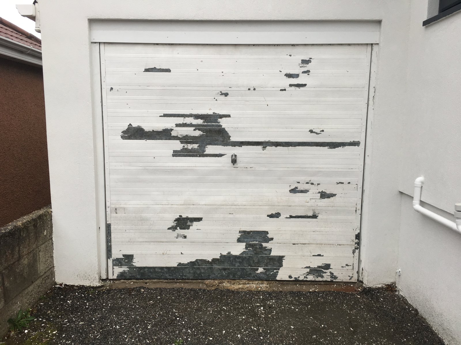

Hi,
I a re-painting a Henderson galvanised garage door from the mid 80s.
The paint was generally pretty loose, so after 12 hours scraping and a few spots of Nitromorse, it's basically completely bare and rust free.
Where the main metal sheet meets the vertical end pieces, there is some gaps. Can I prime the door (Zinsser Bulls Eye 1-2-3 seems the best bet), and then use ordinary caulk to fill these gaps?
Then for top-coating in Anthracite, I am going to use car paint (It's £20 vs £75 for Dulux MetalShield!), mixed to be rollable.
If anyone has any recommendations on anything I've written please do tell, I've never dealt with painting metal before!

I'd consider using a silicone rather than caulk, purely for weather resistance and the ability to absorb some movement......if you actually need any filler at all?
Choose a primer suitable for galvanised surfaces before you top coat.
John :)
Fair play to you phatboy (y) I just leave random shaped patches where it flakes and slap u/c + gloss on;) As to car paint I'm not sure because it's changed so much since it was cellulose - But you may find that an agriculture supplier has brushable "plant/tractor enamel"- worth a look - small roller for the panels and a 1inch brush for the deep grooves. Apply the silicone After it's finished - paint don't like sticking to it.

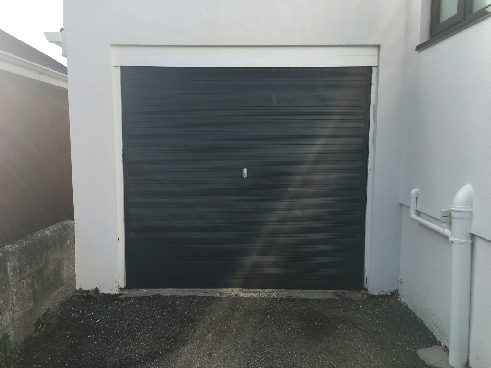

Hi all,
So, the door repaint is complete! In the end I spoke to a local car paint shop, who were able to make me a better product for less cost!
I have used Selemix 10% gloss (So pretty matt), in Anthracite (RAL7016). It is 4 parts paint, 1 part hardener so is completely set and weatherproof in 2.5 hours, and 'hard dry' in 16 hours. It also goes straight onto bare galvanised steel, and requires 1 coat.
I nearly got away with 1 coat too, but the first part of the door I hadn't quite got the rhythm yet and so some of the 'dips' didn't quite get filled so I had to re-coat it.
As the colour change was so extreme, I also used a brush to push paint under the vertical edge pieces, so it looks good from all angles and completely hid the old white.
Full set of pictures, including new handle below!
All in all, pretty pleased with it, and just need to full and sand the frame before painting to match.
