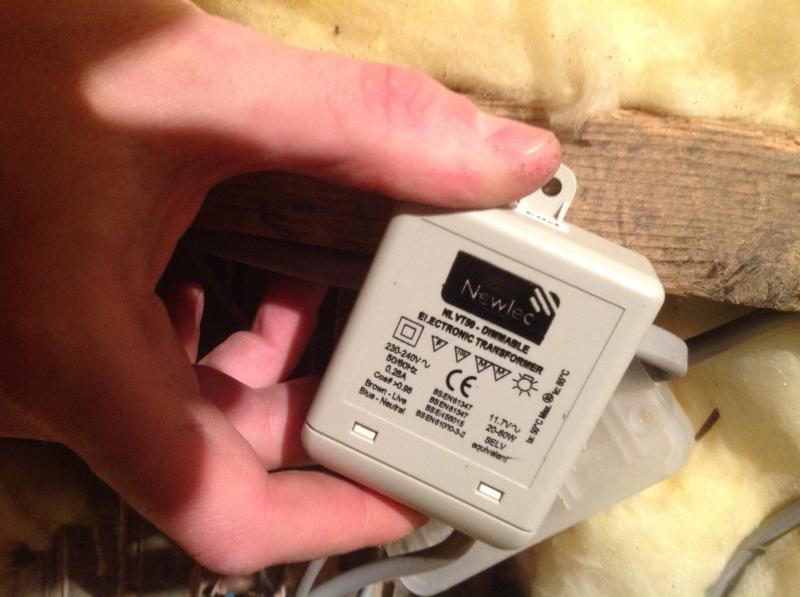

Managed to get up the attic today to see what transformers are on these bathroom lights
I could explain but I think a photo would be best
Not sure what any of that means but am I right in thinking that the bulb to be used with this transformer should be in the range of 20-60w??
Hence my 9w total led lights didnt match up - hence ive worn out the transformer maybe
Would one of these perhaps be better suited
http://www.tlc-direct.co.uk/Products/LTYT50.html
0 t0 50watt range
