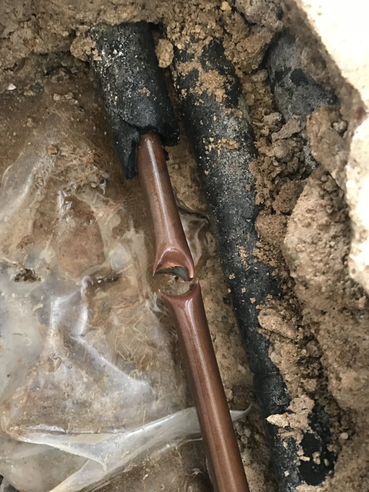

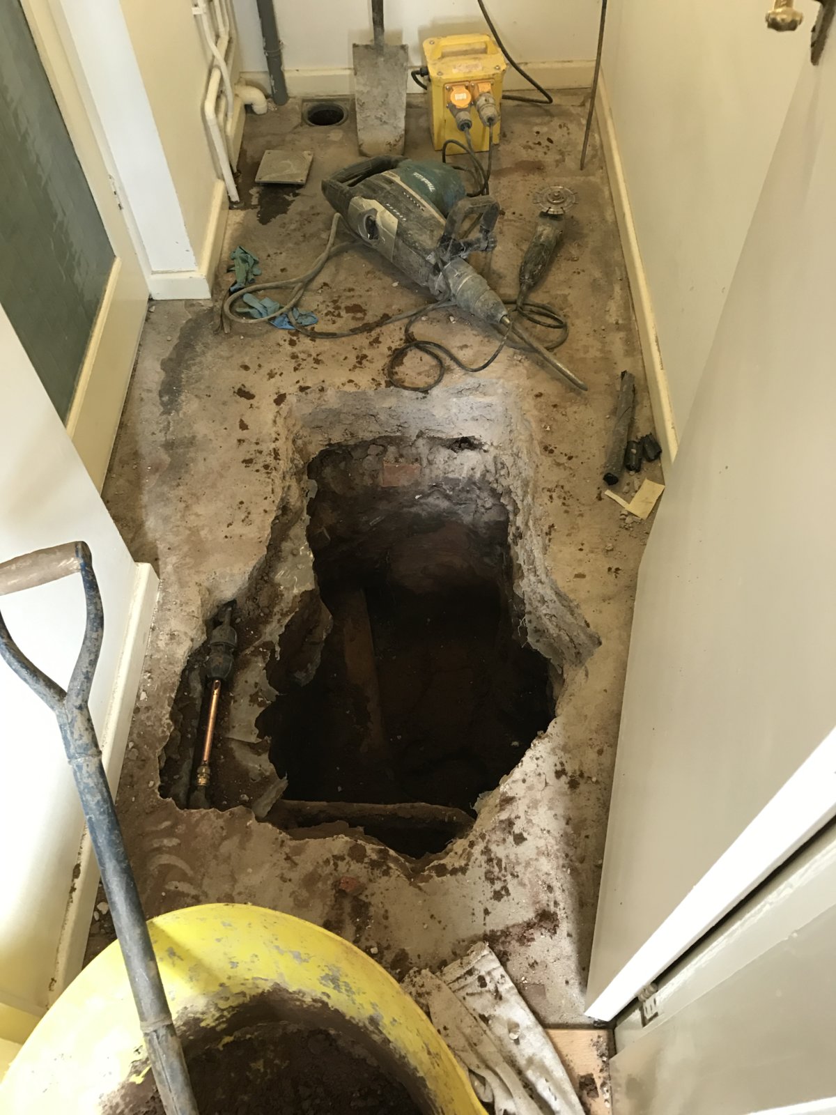

Shame it was us though, we are digging up a rooted junction in here which was bad enough without the water pipe:
