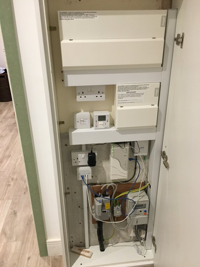

Hi, seems this thread got busy overnight!
There are 2 pairs of tails leaving the meter. It's actually 3 tariff. 1 pair is for the storage heaters only, marked off-peak. The other pair is marked 'general domestic', and has a day rate and a night rate. I get 8 hours of off-peak storage heating, in a 4 hour night block, and 2x 2 hour day blocks.
I would not have space for any additional switches, this is all located in a cupboard in the hallway.
Tim
Also, the supply is approved for 100amp, the cutout was replaced a year ago and a new earth provided.
You have more 3 pin sockets in that switchboard cupboard alone than I have in my entire living room! one lucky man with 3 terrifs as well.
( In short a 100A supply or meter is not going to make you use all 100Amps, but it allows for any increased energy needs in future.Just that you are worried about the size of your meter tails, so if you were able to provide a double pole isolator switch near the meter or just below it, even if sideways, you could then replace your meter tails in your own time to handle 100amps, without having to ask them to come and isolate it for you and incur additional charges. They would wire their meter tails capable of handling 100A into your DP isolator and then you reconnect your new 100A CU tails into it.)
.... so if you were able to provide a double pole isolator switch near the meter or just below it, even if sideways, you could then replace your meter tails in your own time to handle 100amps, without having to ask them to come and isolate it for you and incur additional charges.
He has two sets of meter tails, hence would require two isolator switches to do as you suggest. Unless he actually wanted isolators, I'm not sure that would offer a benefit over simply changing the tails now (if he feels he has to).
Kind Regards, John
Ok. I was wrong about one switch by thinking it was a new installation.
However, haven't we decided that at least the off peak doesn't need an additional fuse as the tails will be protected by the heater OPDs?
So, one switch for the 24 hour supply if not protected by the OPDs or, indeed, maximum demand.
This still comes back to the definition of a 100A supply. The DNO has installed a 100A supply - i.e. cables rated for a 100A fuse.
This does not alter the fact that an 80A fuse can replace the 100A one if you so wish.

I'm not sure that anyone has "decided" that, but it corresponds with common sense. It obviously leaves any faults within the tails themselves (very unlikely) getting fault protection only from the cutout fuse.
This still comes back to the definition of a 100A supply. The DNO has installed a 100A supply - i.e. cables rated for a 100A fuse. ... This does not alter the fact that an 80A fuse can replace the 100A one if you so wish.
Electrically, that's obviously true, but I can't speak for the policies of the Jersey DNO. As you say, the provision of a 100A supply seems to be a fait accomplis. However, I'm not clear as to whether phatboy has asked (if such is what he would like) if they could put in an 80A cutout fuse, despite it being a "100A supply".
