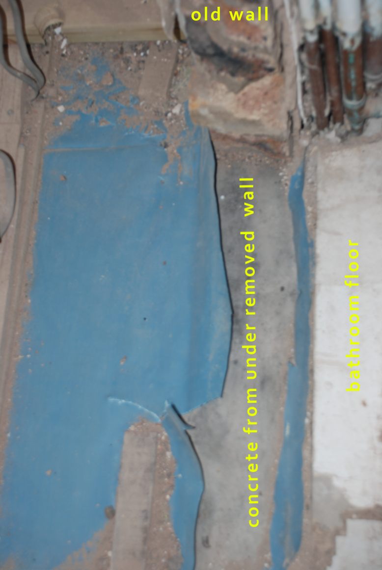

I'm in the process of extending my bathroom (one of the remaining parts of the old extension) by knocking down a non-load-bearing wall, and was intending to lay a pipe from a new shower under the floor. Surprise - the floor turns out to be concrete, rather than the expected suspended floor, so I'm now hoping to cut a channel in that to accommodate the shower waste pipe.
What I don't understand is what the original builder was trying to achieve with his construction: As you can see in the picture, the concrete subfloor on both sides of the wall I've removed is covered in a blue plastic sheet, which I presumed to be a makeshift DMP. Wooden staves and then chipboard on top of the plastic on either side of the ex-wall.
The wall that I've removed also sat directly on the concrete, but there is no DMP in sight - not on the concrete or in the wall itself. If the blue plastic is a DMP, I would have expected that to have continued into the wall, or any moisture would just travel up the wall.
Can anyone advise whether the plastic is probably a DMP intended to prevent moisture rising up, or is it possible that it's to prevent moisture going down into the concrete and that there is a genuine DPM at the bottom? I need to understand so that I can cut the channel without compromising the damp-proofing. Thanks!
