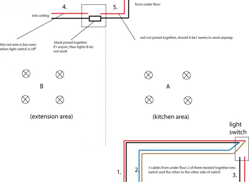

Hello,
I am trying to replaster the kitchen, and the wiring is all over the place.
I am trying to tidy it up a bit, but I am confused about how it is wired.
I have two sets of LED lights A and B, B are in a more recent extension.
I have labelled the wires I have, and done a diagram (i havent included the earths but you get the idea)
where wires 4 and 5 meet is in a really silly place on a doorframe, it has a backbox so probably used to be a switch, but I need to take it out. on one side of the kitchen
I am wondering the following, presumably 4 goes off to the lights... ?
why is the red live the whole time? should it be connected to the red on 5? it is not at the moment and it all works. if i disconnect the blacks from each other, then one set of lights doesnt work.
(i dont need independant control, just all 8 on at the same time.)
at the other side of the kitchen is 1 2 and 3 wires....
is 5 the other end of 1.? or possibly the other end of 3? i am confused!
many thanks for any help identifying things! is there something obvious i should be doing to tidy things up?
Presumably, but electrical installation by guesswork and assumptions is a Bad Idea.
It might not be - what are you using to test it which says it's live? If it's a neon screwdriver or magic wand then these are unreliable and potentially dangerous. You should use a proper 2-pole tester. If you don't already have a multimeter then get one. You're going to need one to help identify cables anyway.
Then it doesn't need to be connected. If you don't know where it goes you shouldn't connect it.
So therefore that's the L or N for those lights.
i am confused! ... is there something obvious i should be doing to tidy things up?
You must, by a combination of physically tracing the conductors and continuity tests with a multimeter, positively identify everything.
It will be a good idea for you to know how lighting circuits work. //www.diynot.com/wiki/Electrics:Lighting
So where are the switches that turn each set of four lights on?
Are they at the same switch plate (2 gang plate) or located separate from each other?
Why the red core conductor is perm live at junction would be hard to say without further investigation, could possible be a redundant part of the circuit that was been left live!

at the moment it is the switch that turns all 8 lights on.
i thought the cable the other side of the room had nothing to do with anything until i disconnected the black wire from it and 1 set of lights didnt work.
Could you please do us a favour?
Repost your diagram showing how the lights are connected and where they are switched from.
You said you needed all 8 on but your last post implied you had one switch to do that.
No wonder you are confused, so am I!!
