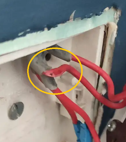

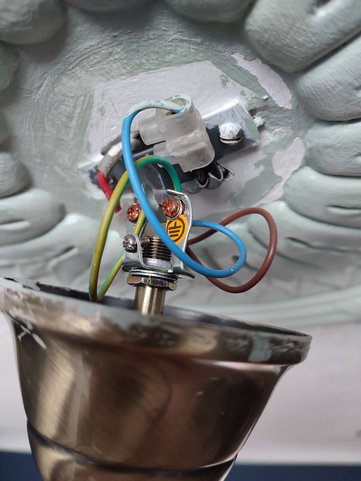

The wiring is for a light fitting that I want to remove. It looks to me like there's one live switch wire, and all the other wires are going into the 'neutral' terminal. It just looks wrong to me.

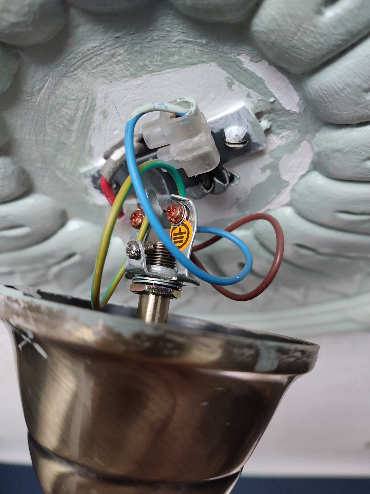

I am not an electrician---- the wires running into the actual light are a permanent live and a switched live (oh, and the earth).
I would guess that the neutrals are hidden in the cavity above.

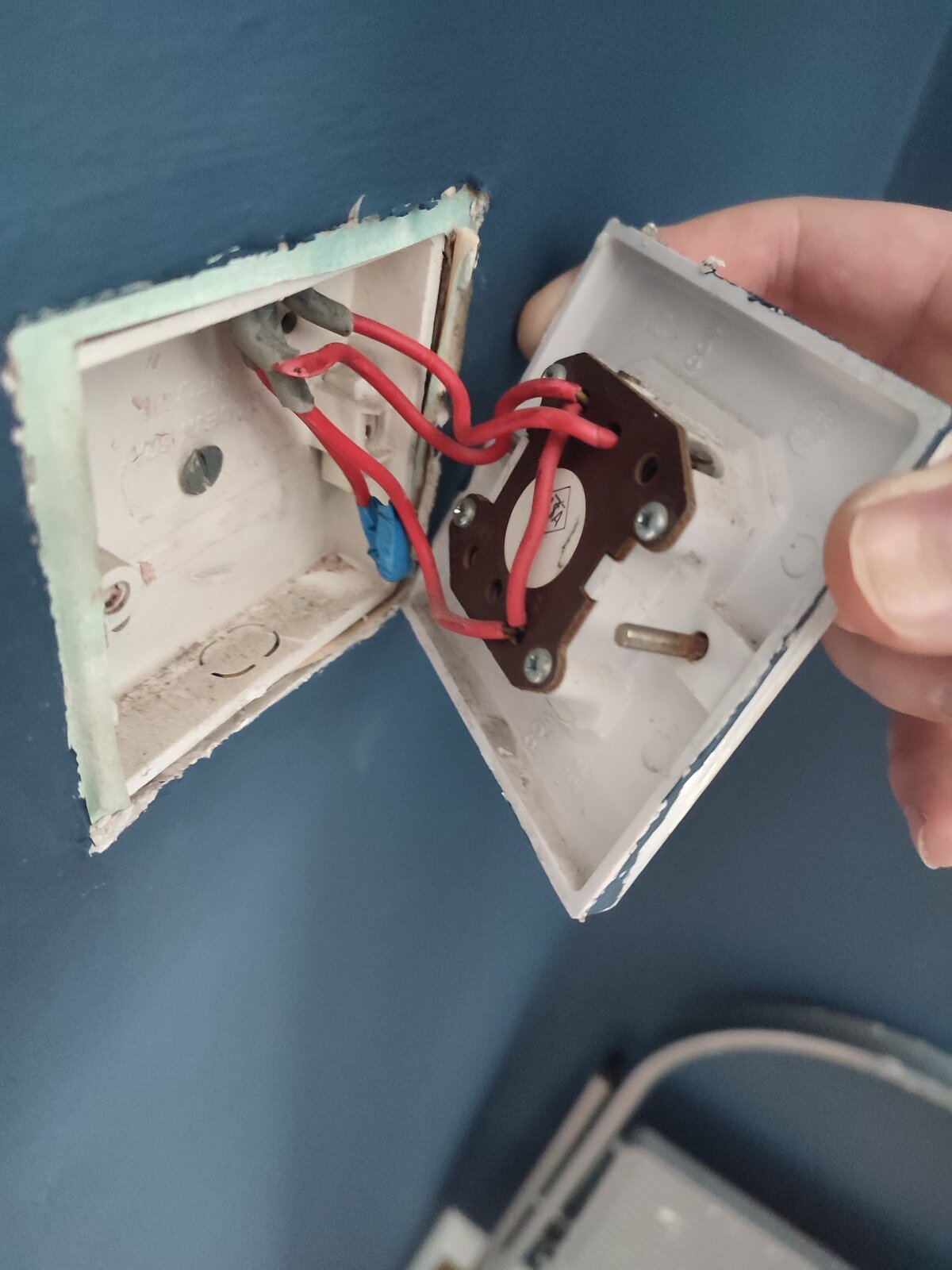

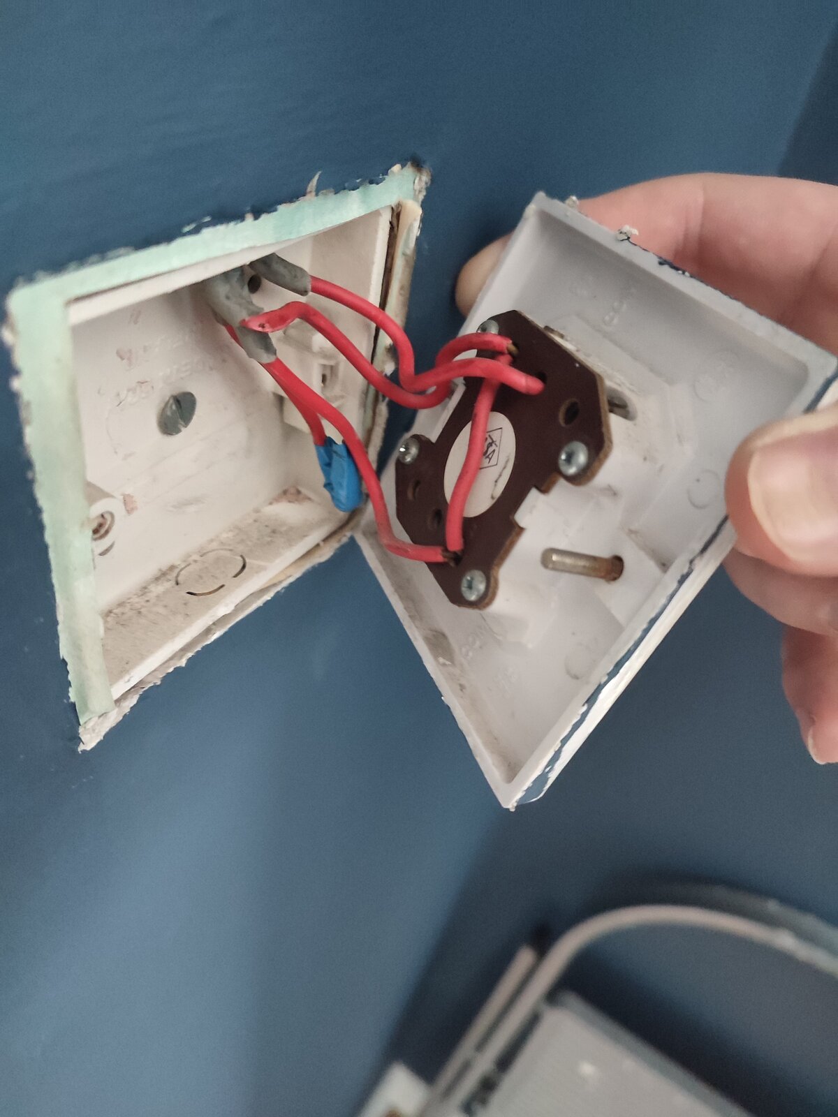

Neutrals looped at the light, lives looped at the switch.
Switch should have 3 red wires.
Thanks! I checked, there are 4 red wires at the switch, but one is taped off.
So 1 live from CU/previous switch, 1 live to the light, and 1 live to the next switch then?
What is confusing for me then is that there are 3 neutral wires at the light fitting coming from the ceiling. What is the 3rd one for?
Yes. It's a method which was commonly used with conduit wiring.
Taped off wire would have been for another light.
Has the advantage of slightly less wire used.

I'll make a guess the extra red and extra black are for an additional light or a light socket at low level for a table lamp perhaps.
