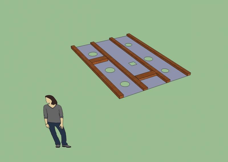

You should get a holesaw to fit in a drill, as near as the size specified in the instructions. This will give you a neat hole in the ceiling.
Note where the joists are. Make sure you leave at least two inches from the joists. Make a few small tests holes with a bradawl to check you are clear of joists before drilling any of the big holes. Make a test hole in the centre of each light position, then 4 round the perimeter to be sure. Angle the bradawl to check for any nearby joists.
If you are having these lights in rows, use a chalk string line to ensure they are in a straight line. It looks terrible if they are not in a dead straight line, and it's very hard to rectify later.
Keep measuring and checking before you start drilling holes.

I'm only using 6 lights. Three in a line down one side of the room, three down the other
I'm going to be re-plastering the ceiling so it doesn't matter if I do some cutting.
CIRCUIT
I assume I connect the TE cable hanging out of the ceiling to the first light using a chocblock
But how do I connect the second light to the first one if both fly leads for the first light are being used?
And how should I get the cables through joists and noggins? When I encounter a noggin should I cut away the ceiling at this point? How should I go through it?
