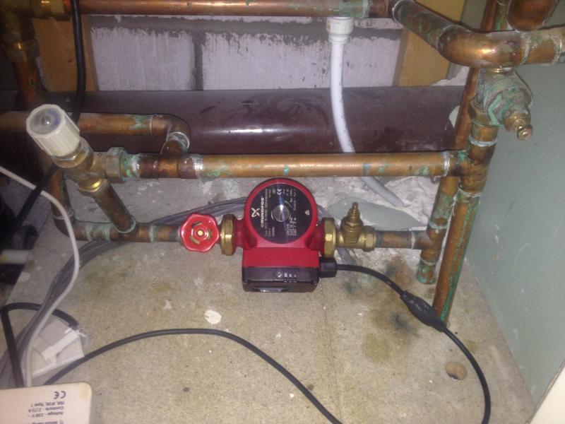

We had air in our central heating system last year, it started as a whistling air sound in the boiler but eventually got so bad the pipes started banging and the heating was failing constantly. I had to bleed the pump and radiators to keep the heating on but we eventually had to get an engineer in who replaced the pump.
Well the whistling air sound in the boiler is back. It seems to only happen if only the heating is on. If I switch the heating off and switch the hot water on, the whistling air sound goes away.
If I have the heating on itself, and the whistling air sound in the boiler starts, I can switch the hot water on too and the whistling air sound goes away!
Any ideas what's going on its driving us nuts lol
Is the middle pic displaying the correct way up? If so the pump is fitted incorrectly. That would not necessarily explain your noise though, just that it's wrong. The motor should be horizontal.
Yeah the middle pic is displaying correctly. The original pump was in the same position too.

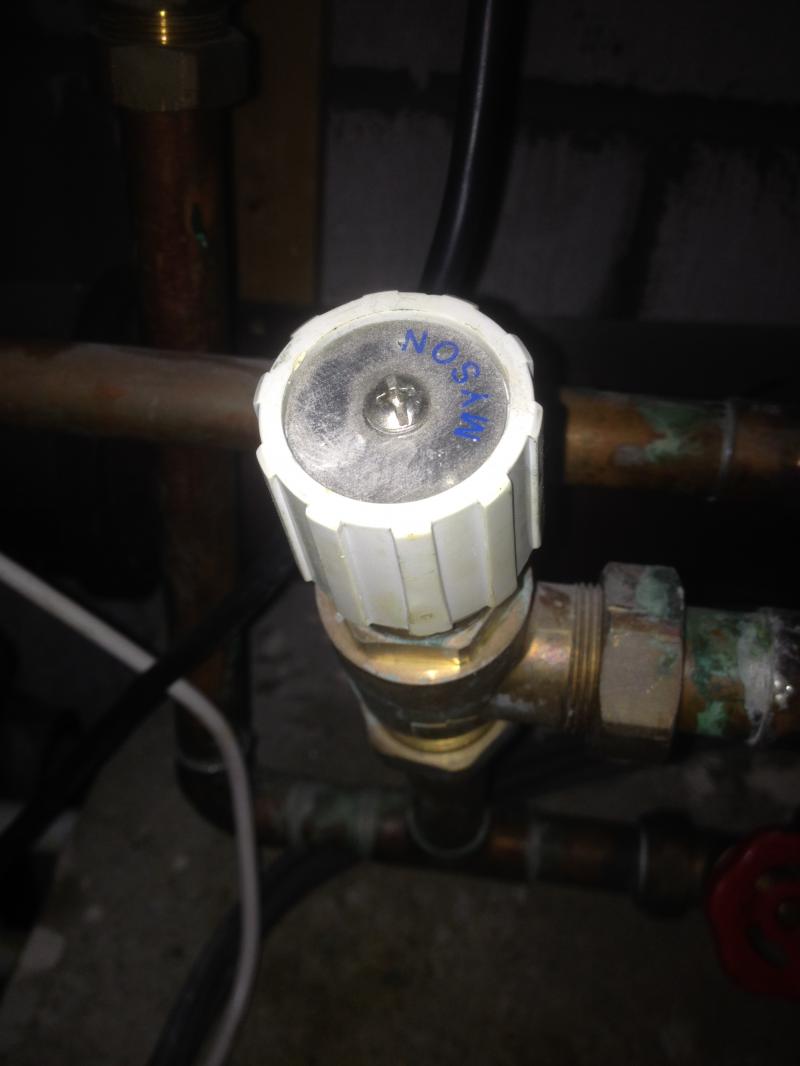

Try adjusting the light-grey-topped valve in the middle picture, while you have the whistle. I'm assuming it's an automatic bypass valve, I can't quite see well enough. It would be adjustable between about 1 and 5. What's it on?
What model of pump is that and what's it set to? (Speed?)
I'll try adjusting the valve but there are no numbers on it?
The pump is a Grundfos UPS2 15-50/60, it's set to speed number 2 (the middle one)
I switched the heating on this morning and it was running quiet, but that's normal, it runs quiet when its cold. Its only when it starts to get warm the whistling sound is there.
Sure enough as it slowly starts to build temperature this morning, the whistling noise/air is creeping in.
I have adjusted the light-grey-topped valve and the pump speed but it makes no difference, the whistling air in system sound is still there.

I would still be suspicious of the pump. As mentioned above, it should not be at an angle but horizontal. I can see why it is in that position but I think it could be damaging the bearing - which could be the source of the noise.
Also as this is the second occurrence of the noise - and that was cured by a new pump - maybe?
Just my thoughts, that's all.
