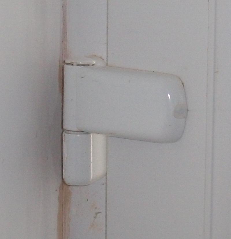

A friend had new windows and doors, the supplier of which promptly went bust leaving him with no warranty. The back door was obviously installed by a blind idiot.

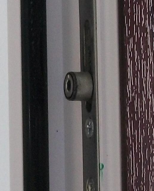

I've fixed one problem by dropping the striker plate by about 1/2". But it could really do with moving out a bit away from the hinges as some of the latches barely contact the striker. You can see on this photo that the roller only just touches the striker.

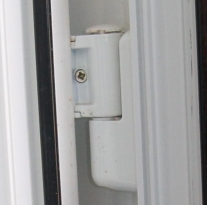

So can these hinges be adjusted laterally ? Is so, how ? There's a visible screw in the back, and hidden behind a small plug on the front/end there is a hex (IIRC) socket.
Take the cap off and wind the hex screw so the door moves closer to the keep.

take the little cap off the right hand side and use an allan key to move it horizontally, do all three the same amount though or you will cause problems!

take the little cap off the right hand side and use an allan key to move it horizontally ...
I'll give it another go. I did have a go before but it seemed to turn a little bit and then go tight, and I didn't want to force it. Should I be slackening off any other screws (eg the one on the back) first ?
There are a few niggles like this - that was the worst, but some of the windows could do with adjustment and so on. All the sort of thing an installer doesn't have time for when they've been given an impossibly short time to do the job to keep the quote down.
you dont need to slacken anything, it will be pretty stiff though dont worry, only worry if is turning and not moving
All sorted now, just a matter of having my hex keys with me. Last time I tried I only had my screwdriver bits and they didn't reach deep enough. If only all the other problems were as easy to fix :rolleyes:
