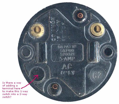

Hello
I've got an old light switch that I really like the design of and I'd like to keep if possible.
The problem is, it is a 1-way switch and I want to install a 2-way system in the room it's in.
Is there anyway of converting this switch into a 2 way switch?
Matt
No. Its not just a case of sticking a terminal in there, there are internal connections required also.
Best bet would be to look for some site that do reclamation supplies.
Damm! Beaten to it. ;)
Thanks for your help.
I thought that might be the case.
I'll have to use my switch in another room.
