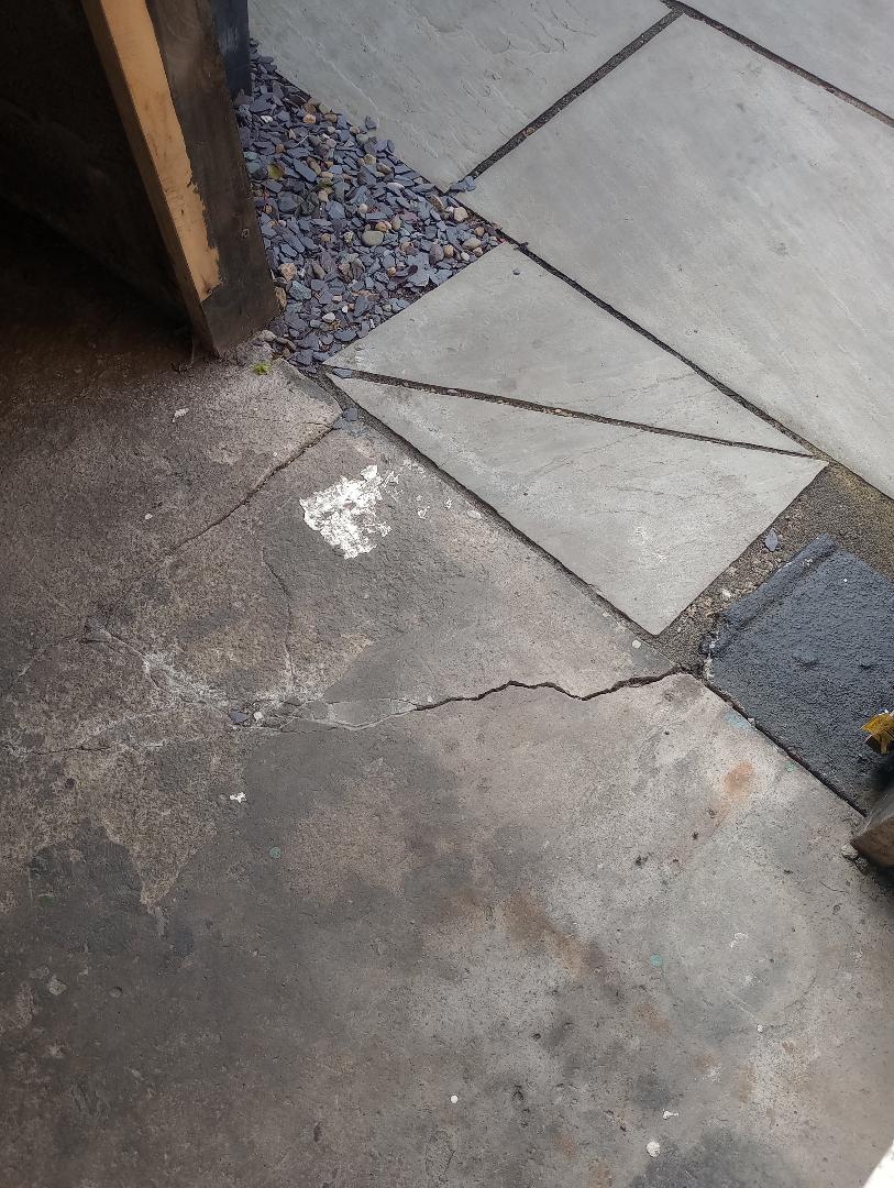

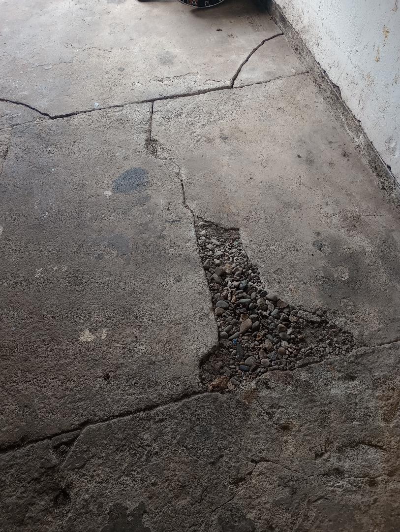

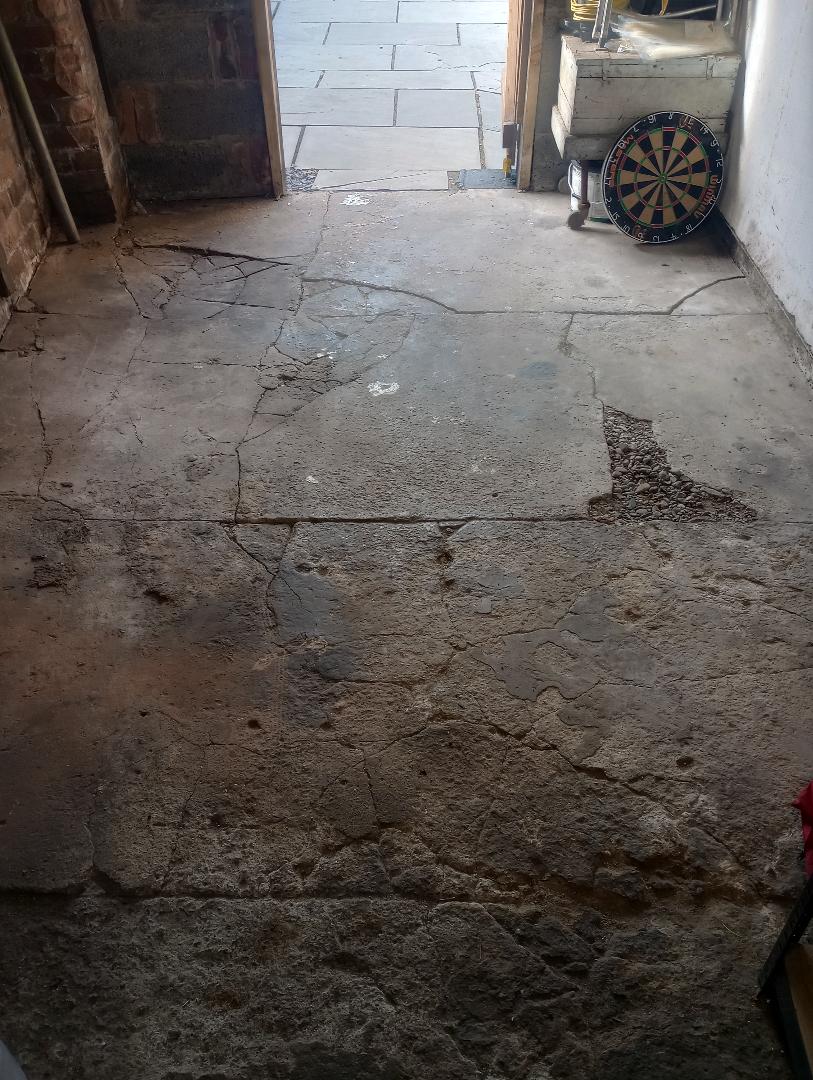

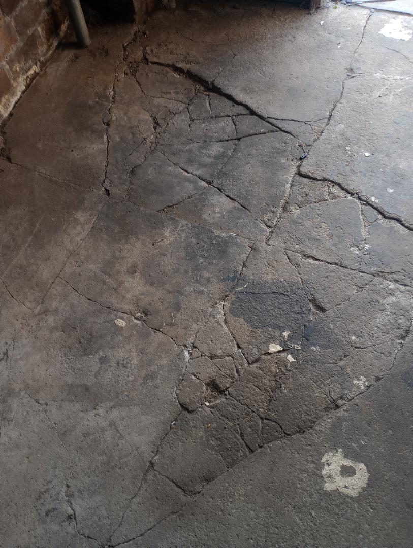

The photos show my 'seen better days' garage/outhouse floor. Its got more potholes than my local high street and a few cracks and gaps. Question is, if I want to get a smooth surface (mainly to work on my motorbike) what is the best solution? Lay fresh concrete or other surface material on top? Dig it all out and start again - don't fancy this option! I only need the front part of the building to be repaired (approx 2.5m x 3.5m), the rest of the building is storage and shelving units so most of the floor space is covered. No too fussed if I ended up with a lip on the repaired area. On the plus side, its dry and I dont get any damp coming up through the floor which was laid around 1986. Thoughts? Costs? Cheers all.
If it's overall fairly level then a few sheets of plywood would get you an easy flat surface. Any screed or similar may well crack again as the concrete cracks/subsides further over time.
Thanks. What could be used to pack out the gaps underneath the ply where the floor is uneven?
Ply is great if it's fixed down. The second it gets moisture in it it will start to curl. You will regret it.
Dig it out and replace it with something more substantial, than the 2" rubbish that's there.

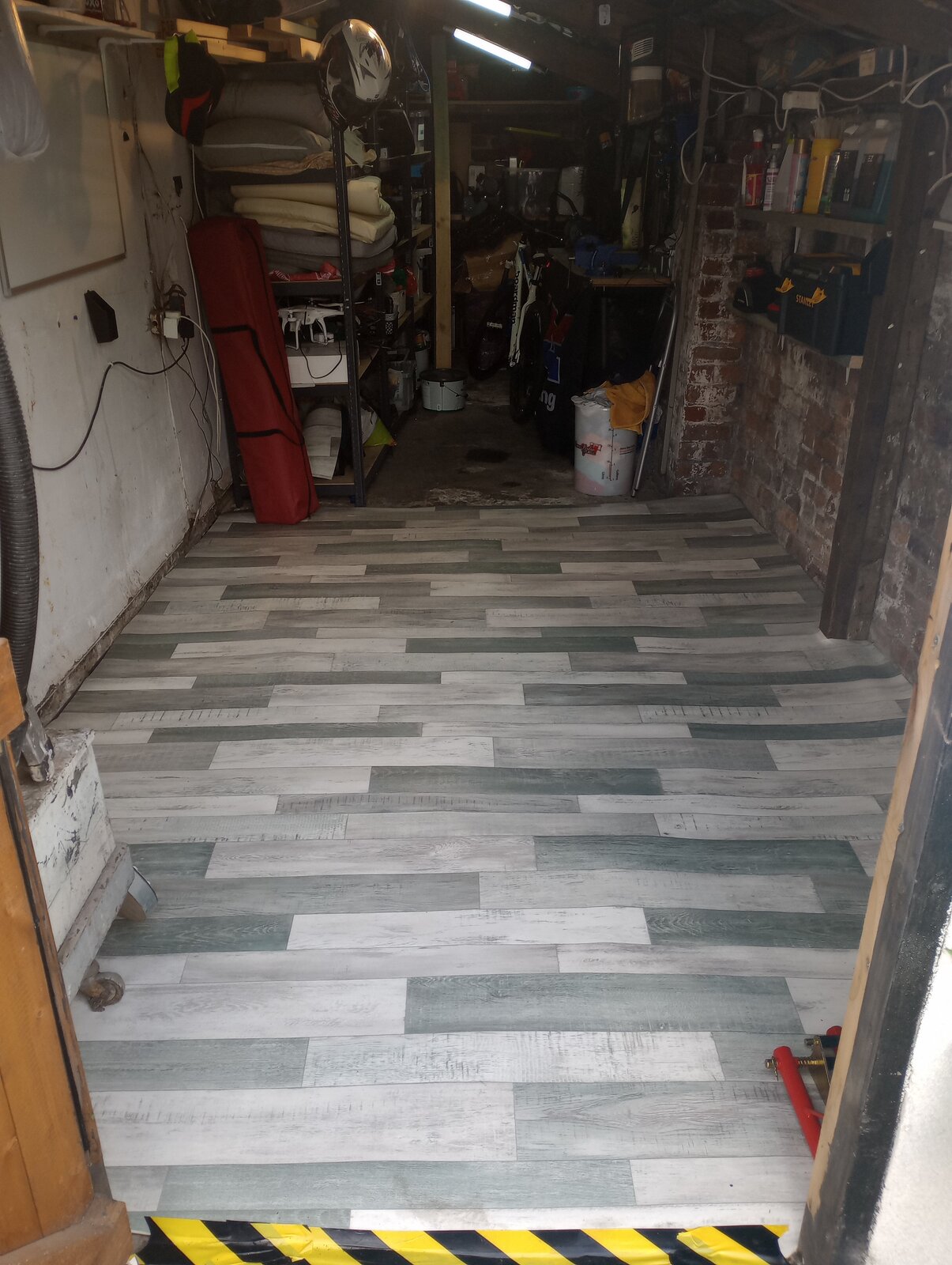

Thanks all. I remembered I had a pile of foam interlocking tiles tucked away so I put down a waterproof sheet then the foam tiles and bought a cheap piece of roll end lino from a local carpet shop. Not perfect and had to build up the lows with extra foam pieces but looks tidy and for £60, if I get a year or two out of it I'll be happy. Got a steel plate I can use for the motorbike side / centre stand.
