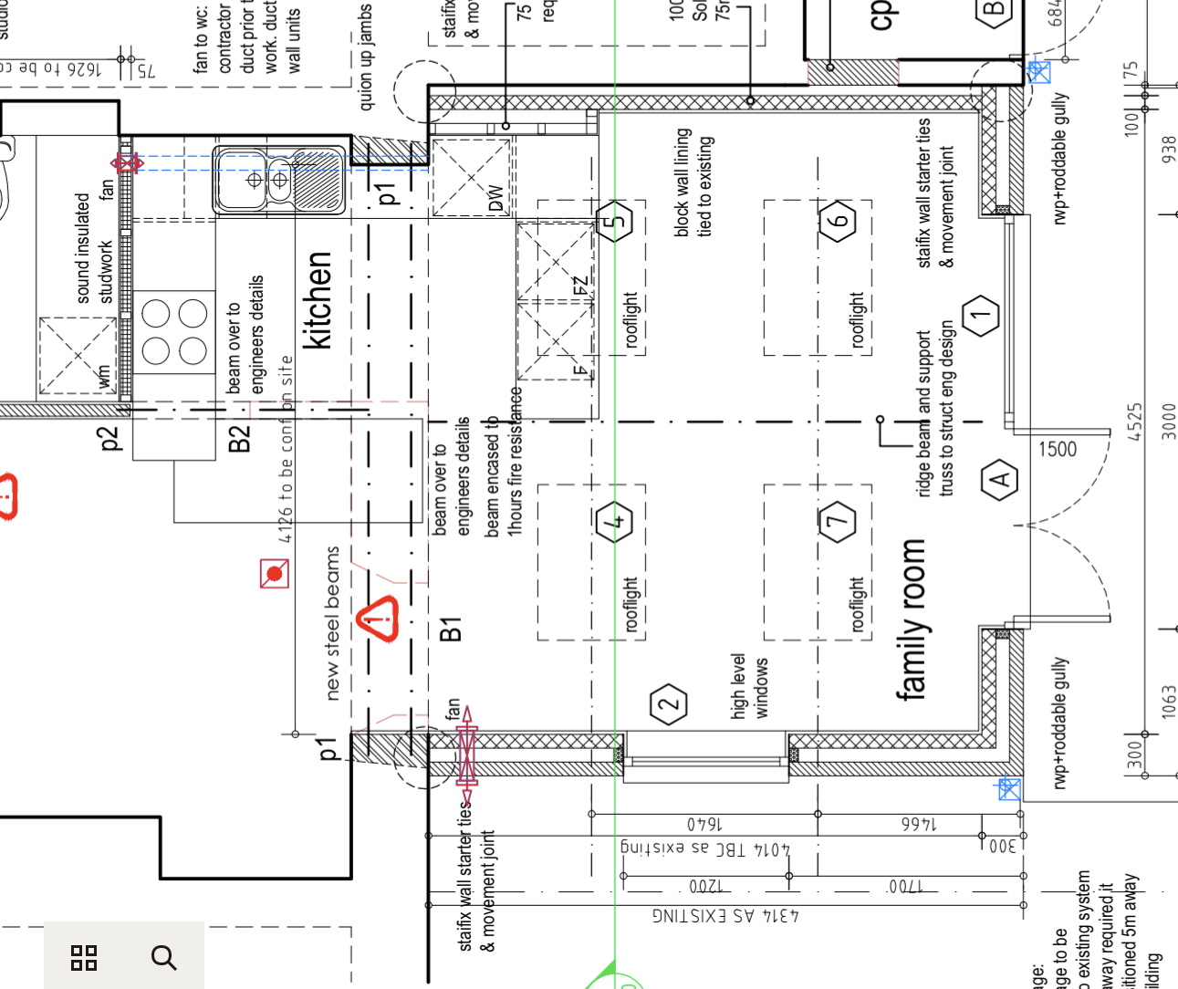

We are putting a kitchen in a new extension. We don’t want a typical hob extractor over the hob. Can we use a fan extractor in a wall, like you get in bathrooms, that vents to the outside and still comply with ventilation building regs?
If so can the fan be located in any external wall in the kitchen or does it still have to be over the hob?
