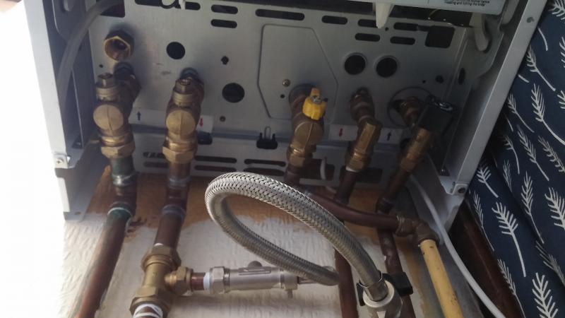

it is a Vokera... Would fitting a PRV to it be a straightforward task?

To be fair to the 'cowboy' I can't actually see any PTFE on the threads, he was just a bit generous on the olives. PRV not being present would be more cause for concern though.
I think the PTFE is on the olives not the threads. Fitting a PRV is not easy?
That's just as bad, it should only be Boss White used on olives. PTFE on compression olives is poor workmanship. A smear of (joint paste) Boss White on olives is all that's required. Tightening the fittings with dry olives or PTFE round them is not the way to do it.
