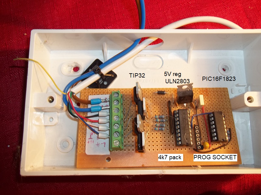

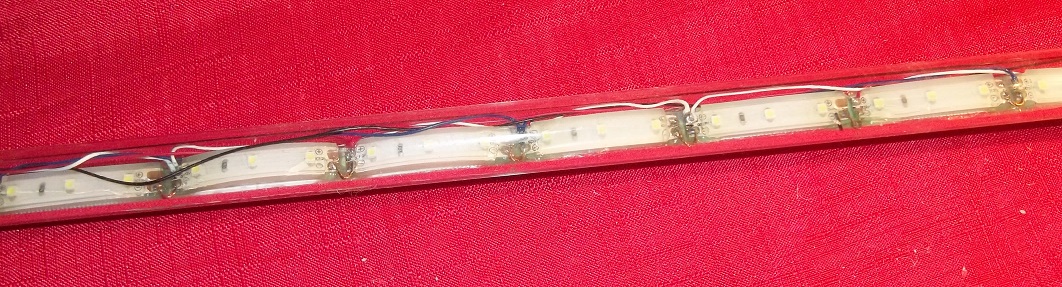

This is the prototype of a Christmas illumination. The tape is divided into it's individual sections of 3 LED element and resistor.
The sections are controlled to create rolling patterns along the tube,
Acrylic tube 16mm internal diameter https://uk.rs-online.com/web/p/plastic-tubes/4084024/ in 2 metre lengths (

That looks like a fun project @bernardgreen - are you driving this via an Arduino or something, or can you buy something off-the-shelf?
edit: oh, does each element have its own wire or are you chaining them and pulsing the supply, relying on the resistors to 'slow' it down and get the effect?
