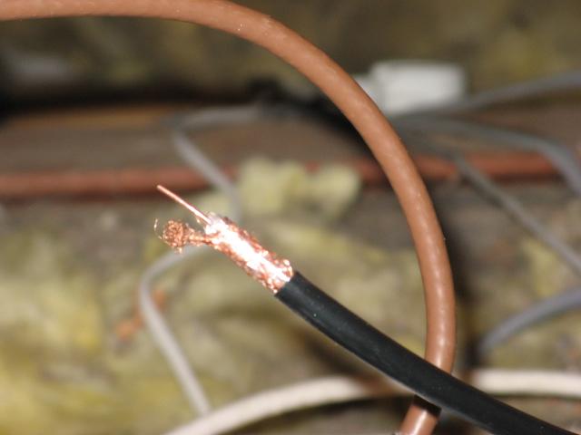

Hi all
Had an aerial guy round today to replace wiring from aerial - dist amp - lounge (a new socket which he also installed).
I specifically asked for WF100 cable to be used throughout (in fact, I originally contacted him just to buy the cable and to do the job myself, but his quote was good and so I paid him do it). He quoted specifically for doing the work and using WF100. After doing the job today, I checked with him that WF100 had been used and he confirmed.
Just checked it now and he's used RG6 from the aerial to amp, and an unmarked black cable from amp to lounge. The black cable has a silver coloured foil rather than copper. I've attached some pics.
I'm really annoyed about the RG6 :evil: and now don't have a clue what the unmarked black cable is. So i wondered whether from the pics and the fact it is unmarked whether anyone could tell me what it might be (or what it's not!!!)
Any other thoughts or advice would also be great. Need to act quick so that I know what to go back to him with.
Huge thanks
Max
I'd say if it's unmarked then there's no way it is Webro WF100.

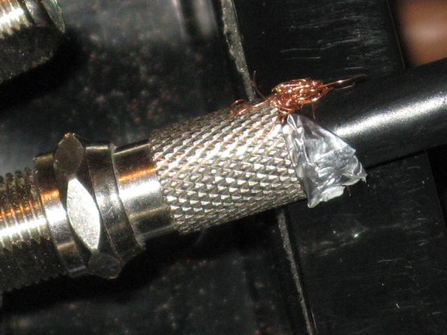

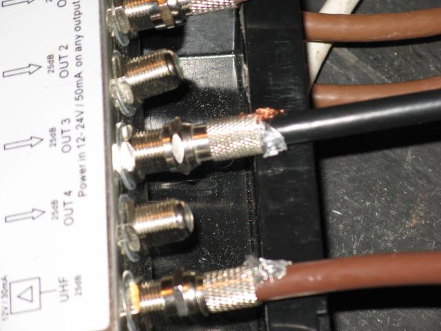

On a side note, his cable ends aren't particularly tidy either. Rushed job??
He was here a fair while and did not seems to be rushing. But I agree, they don't look great. I assumed that might be how it's done "in the trade", but obviously not.

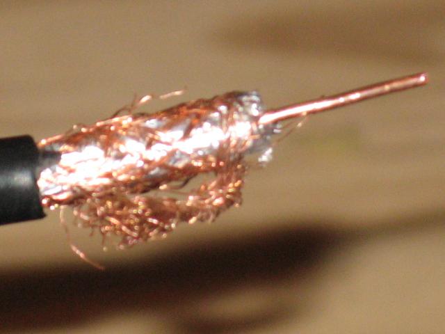

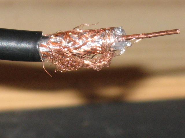

I've got a couple of better pics of the cable now which i will attach. Don't know if they help show how good the quality is/isn't???
Cheers
The copper braid coverage is about the same at WF100 although the filaments do look a little thinner. What's obvious though is that the foil shield is aluminium rather than copper, so it's clearly not WF100.
Aluminium foil in itself isn't intrinsically rubbish. My highest grade coax is Liberty Interflex SD. That has an aluminium foil. It beats the spec of WF100 by a country mile and it's specified as one of the two highest grade 75 Ohm coax cables in the world for broadcast analogue and digital signal use. The other is Belden 1694A. What's important is the spec and how consistently the manufacturer can maintain that in production.
The only way to assess cable for most of us is to look at the spec sheet. Attenuation at frequency for a given distance, and also the return loss are the two key bits of info. There are some specs here on the Satcure website with a useful guide to how the frequency bands relate to typical use. www.satcure.co.uk/tech/cablespecs It's only guess work on my part, but your coax could be closer to WF65 performance. However, with no markings it's unlikely we will ever know. I'll be that's the same for the installer, and maybe even the distributor doesn't know either.

Another check you can make is to touch the inner "copper" core wire with a very strong magnet. If the wire is attracted, it's copper coated steel, which places it firmly in the "RG6" camp (or worse - it could be CCTV cable).
For a Freeview installation, RG6 is fine. The signal losses over WF100 are negligible. The only downside is that aluminium-on-copper shielding is very prone to corrosion so any cable outdoors could suffer. You should take extra care to:

All CAI Benchmarked cable should have the certification number printed on the sheath
List of approved cables here:
http://www.cai.org.uk/information/benchmarking-scheme/cai-benchmarked-cables
The unprinted cable is certainly not WF100 and certainly not approved.
