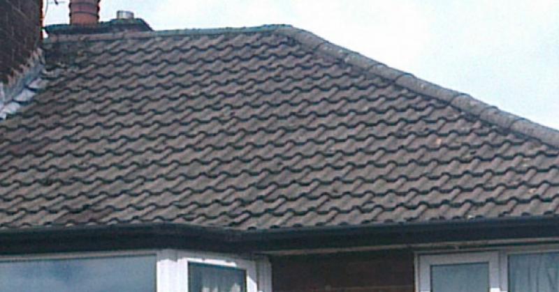

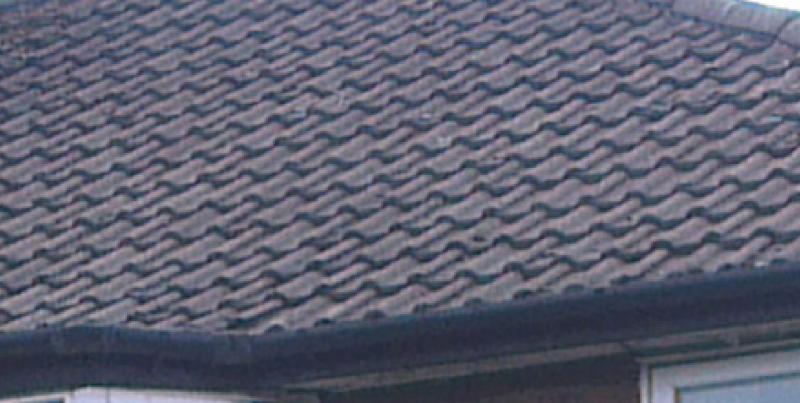

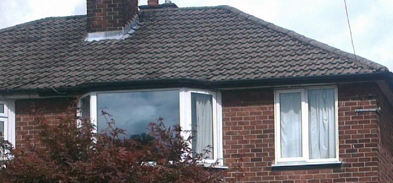

Could you please help identify these tiles so i cant try to find some replacements. These are in Salford greater manchester and a lot of the houses here are the same so i assume ill be able to get them

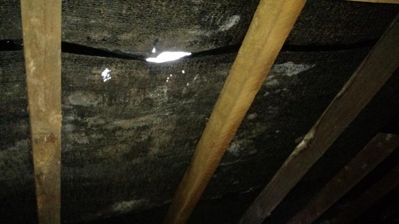

found water in the hallway recently from the loft (no water pipes up there) So I got up for my first proper nose around. right away I found a large hole at least as big as a tile pictured below. I also spotted some more light getting in down in one of the corners, so I assume there is another hole down that way. the loft is pretty dry and from the inside the felt looks in good condition except for where the tile is missing. so im guessing i should be able to just replace the tiles that need replacing after patching the felt. Ive done the usual forum searching and you tube watching, and it doesn't strike me as a job I cant do myself as long as i'm careful at the height.

Health and safety equipment cost prohibitive!!!!!!! only you can decide what value you put on your own life. The tiles look like double roman to me.
The underfelt looks like type 1F underslating felt, and the holes seem to be where the laps have "shrunk". You could probably fix this from inside by sliding cuttings of new felt up, making sure it's lapped such that any water would fall on top of the lower strip, ie under the top strip but over the lower strip.

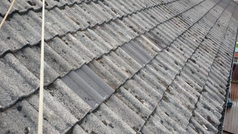

heres a tile example took one down off the roof
its 33 x 42 cm
do they look like something i should be able to find easily enough?

Have a look at the Marley catalogue, looks like Catlad's on the money with double romans.

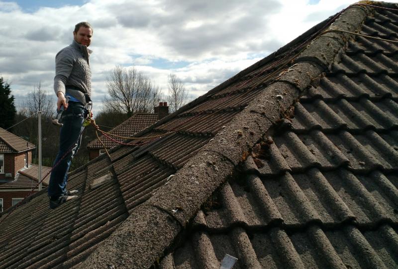

These tiles were indeed marley double Romans which I was able to get from a local supplier. Spent last saturday up on the roof with a fellow climber replacing broken ones. replaced 9 in total including a couple that broke under foot. Was able to climb up to a flat roof at the back of the house and then rig up some ropes around two chimneys to act as two anchor points and work safley on the roof.
total cost not including the climbing gear that I already owned, was £20 and to be fair the job i did was way better than some of the botch jobs i found and repaired while I was up there!
Fair Play to you ! - Catlad has a valid point but ... if you are a climber you've got a lot more savvy than the average Sky Dish Fitter who ponces around in total PPE including a full body harness :rolleyes: They probably moonlight as gimps :mrgreen:
