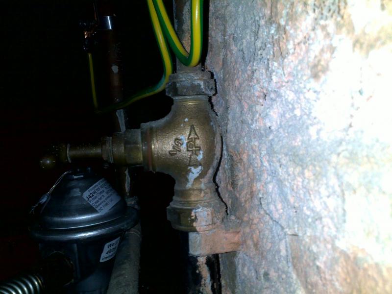

Hi,
A black plastic water pipe about 20-21mm OD supplies my house.
Is that alkathene?

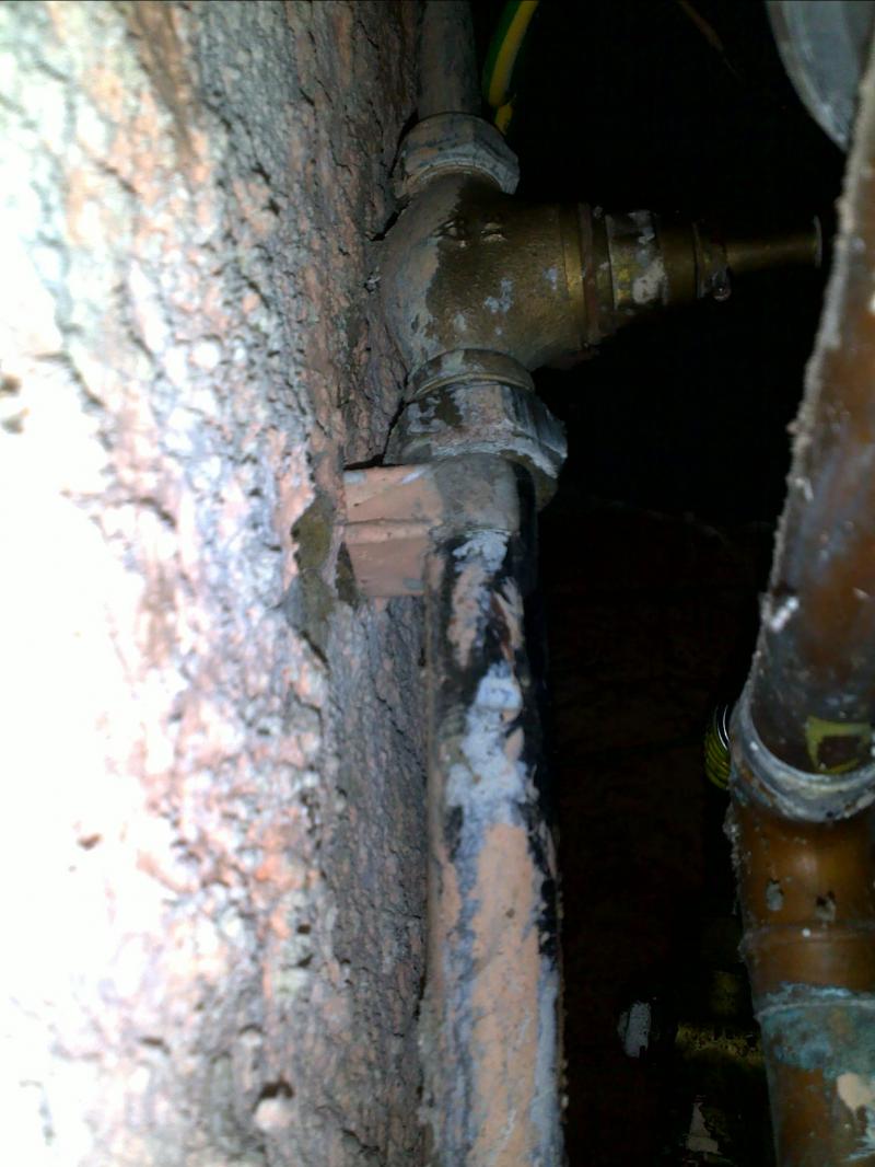

Here's the stop top which joins it to 15mm copper:
You can see one side of the stop tap has a British kite mark and with "31" written above it. On the other side has "1/2" meaning half inch of some description?
Does that mean 1/2" ID pipe? I can't see any other way 20-21mm OD can correlate with a half inch.
Any help would be appreciated.
This then goes down to 15mm copper which supplies the entire house.
Hot water from the boiler dies away when any cold tap is turned on. I'd like to hopefully improve that.
I want to replace the other side with something else; 25mm MDPE?
What adapter or stop tap would I need to get to connect this black pipe to 25mm MDPE?
Thanks.

would say alkathene.
1/2" ID is inside diameter.

1/2" ALKATHENE.
On the pipe will be blue writing (Class C) or green writing (Class D) it's important you get the insert to match.
