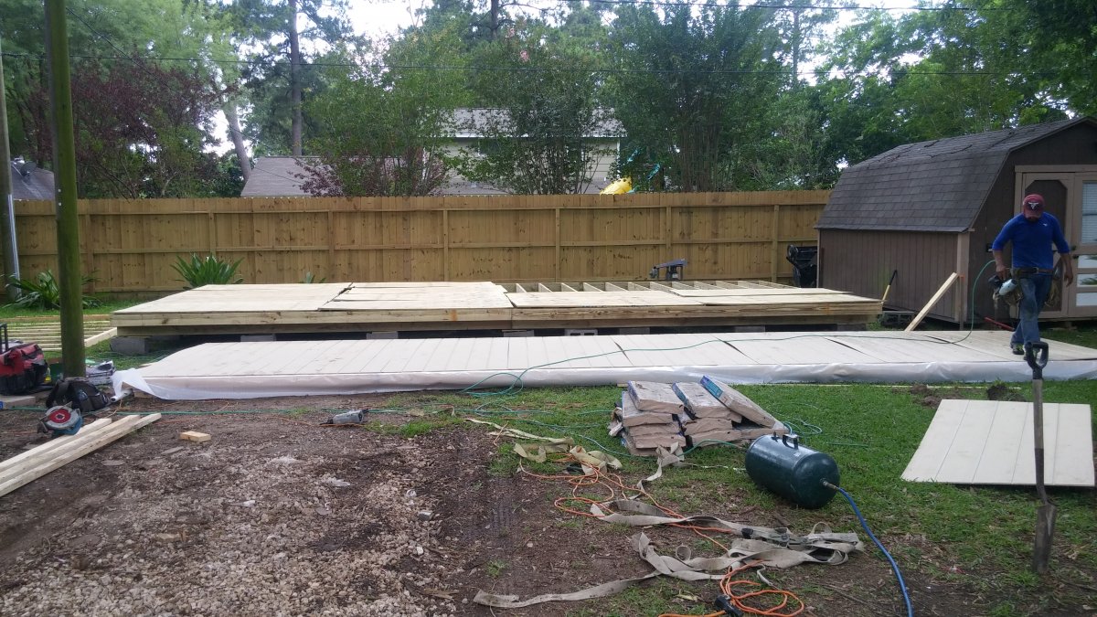

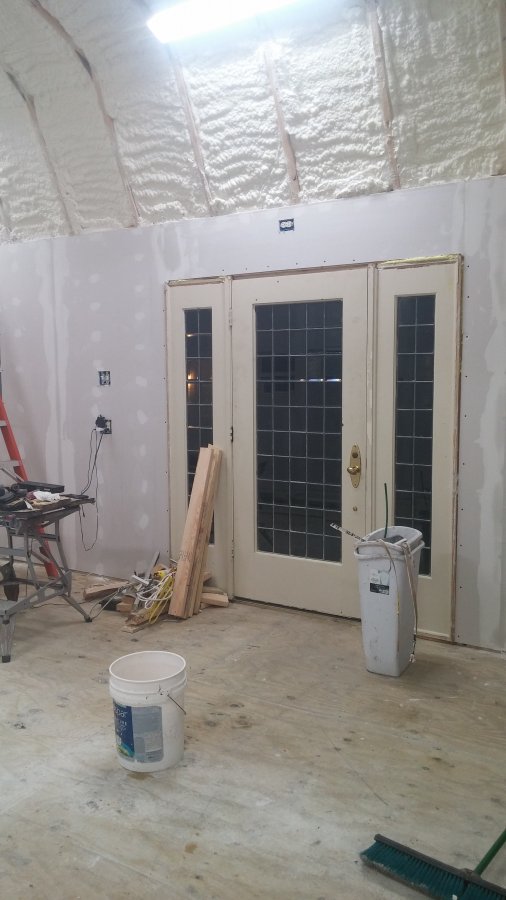

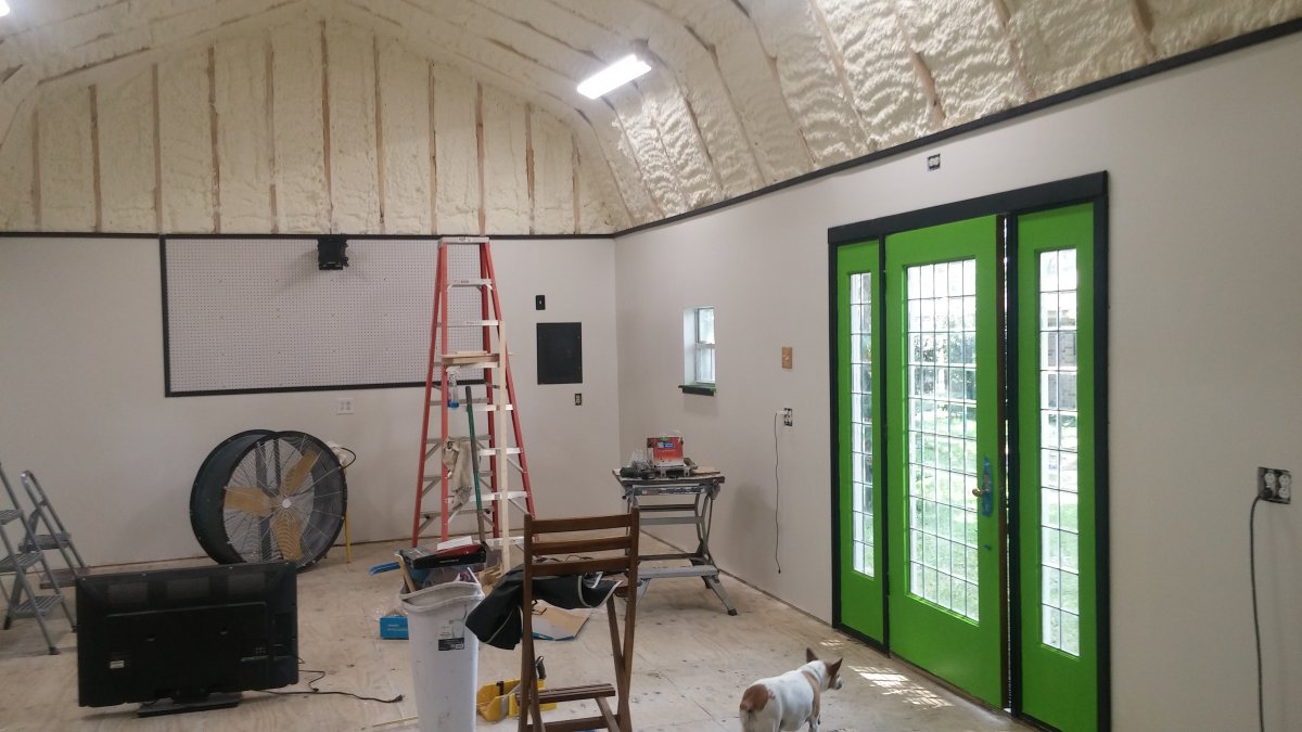

My buddy and I built this shed/shop in my backyard last week. I'm using it for a home business hobby shop. It's 16x31 with a 16 foot ceiling, spray in foam , Q5 sheetrock with no texture. (that was a big pain in my elbow) all trimmed and cooled with 2 of a.c. units and will be heated with natural gas if it ever gets cold in Texas again.
My question...
When I was younger I did things without research and hopes for the best.. We didn't have internet then either... And in my 50s I can't endure another 7 days of labor to build another so I want to do this right..
I want to carpet half and use epoxy on the other half were I will be doing work. I've read both ways. It's ok to paint the topside of treated plywood and I also see folks say it needs to breathe or it will rot. The foot is about 12 to 18 inch off the ground. It's seems it would be ok. But I want some opinions of pros. We have talked about spraying the underside in the future with foam also...
Any help will be very much appreciated.
Joe...
