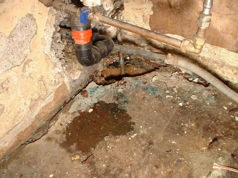

richard7761
My water supply is a copper pipe, and it's protected by being inside a 4" (about) clay pipe. Where it comes up in the corner, it looks like there is 28" distance from the floor level to the bottom of the vertical section of the clay pipe.
Of course, the copper pipe moves freely within the clay pipe.
Can I go ahead and fill that vertical section with sand without causing a problem? Thanks.
P.S. Could I fill with sand if I covered the copper pipe with a close-fitting plastic pipe first?
Yes - or use insulation.
Thanks. I realise I don't have to surround the pipe, I just feel though to stablize it before taking off the old stop cock and diverting the run of the supply pipe. Then covering with sealant where I broke the mastic. I have a concrete floor that was covered with 1" of mastic that was holding the pipe steady. I'm in a "no fines" council house type of house.
Here is a picture of my situation. You see the copper supply pipe coming up inside the clay pipe. I want to have the supply pipe turn 90 degrees along the floor towards the camera view, parallel with the left wall, then turn right a bit (left from camera view), then up vertical to a new stop cock. So, when I have drawer door there, opening the door, the stop cock will be on the left wall, near the front.
You see that there is about 1" of mastic layered above concrete. I've broken that in the corner. I'll have to put something there instead of the mastic.
I was hoping to put the pipe under the sealant/levelling compound for the short run, so the pipe will come out from the floor, just below where the stop cock will be. It's that or everyhting is above ground from the corner.
you mean you want to plug the gap to prevent dirt or vermin getting in?
Climaflex or similar will do fine. If it is not a precise fit, you can shave it down slightly. Armaflex would also do, and is more compressible to squeeze into a tight fit. You can then pack mortar or screed round the insulation.
The clay pipe might be useful one day if you want to draw a new plastic pipe through the duct.
