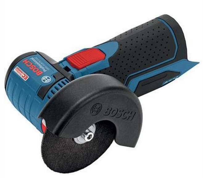

Looking for a tool to remove plaster (solid, very) and metal straps (steel, I think) from old windows, can you recommend anything? Tried angle grinder and it cut plaster ok, but very messy and it just created sparks on the steel!

For the straps, they're screwed to wall in the reveal, the screw heads are rusted so I can't unscrew them but they're still very well attached to the wall, can't prise them off and they're too close to the wall to cut the screws.
If you can't get a grinder in (9in?), try a recip saw with a metal or demolition blade. As ^woody^ says, though, they normally just pry off
Most useful thing for straps and cats ... apparently :rolleyes:
Bosch GWS 12v. Or the Lidl version when on offer (y)
