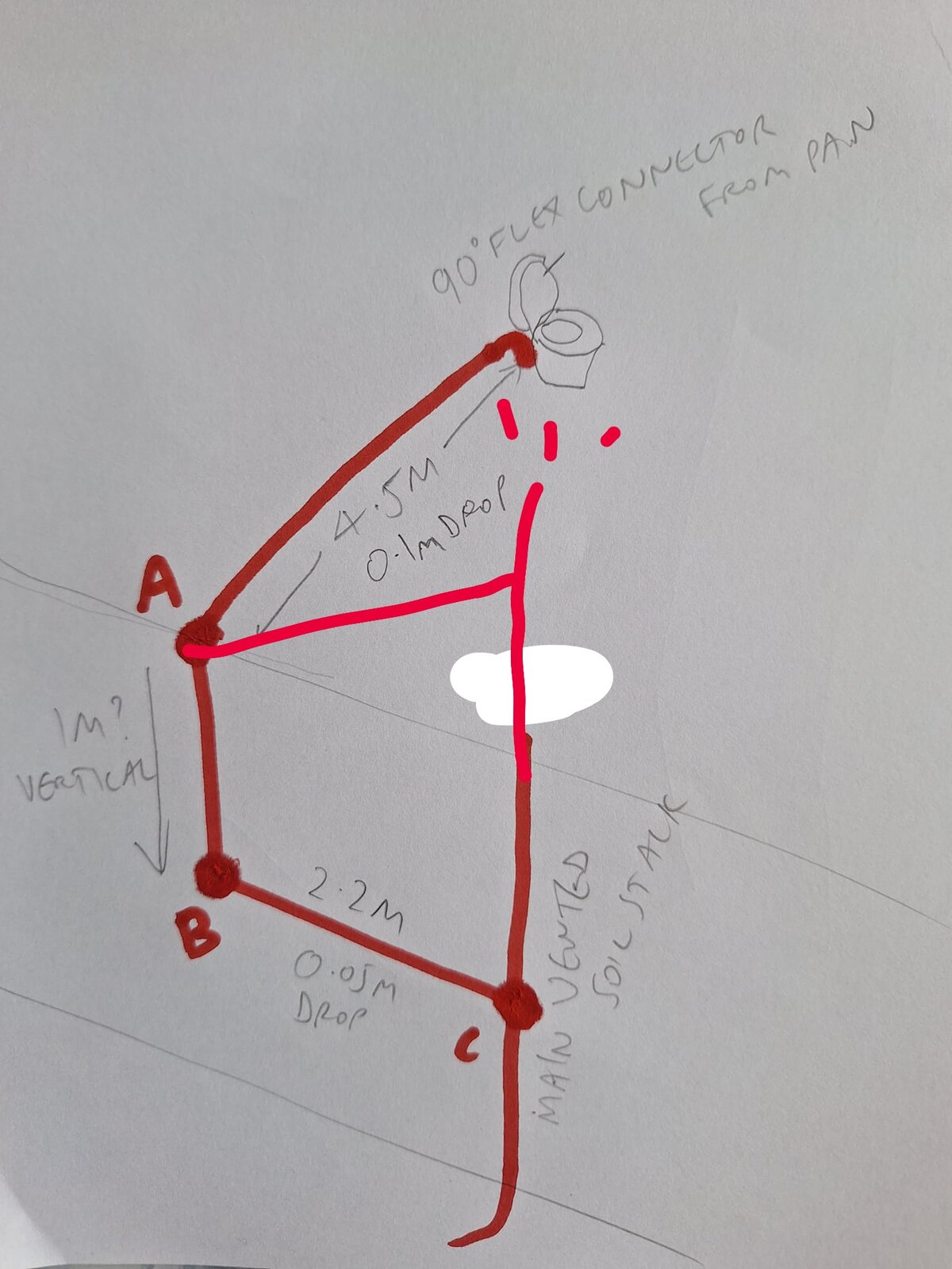

Trying to put a new bathroom right in middle of semi-detached house, on the second floor.

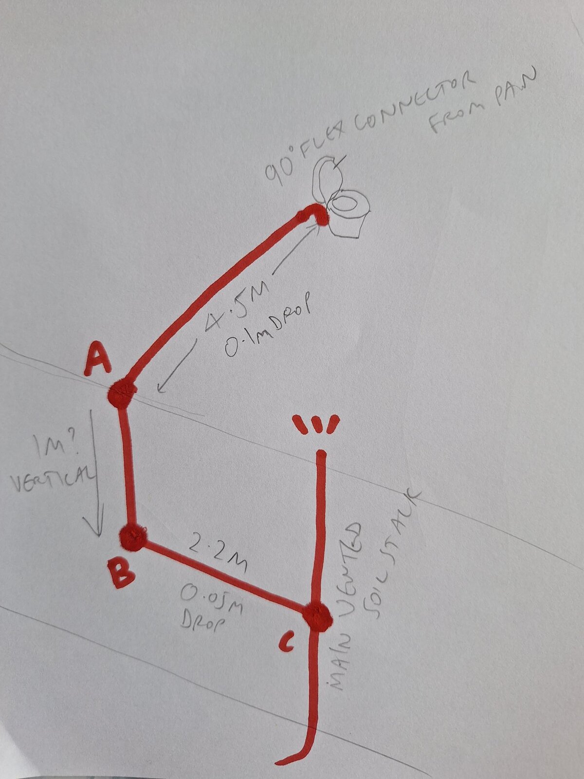

It will have to be a 90degree pan connector and then a 4.5m horizontal run just to get to the external wall (can get a 10cm fall over the 4.5m), then the main soil stack is about another 2.2m and right-angled bend away. But I can put a vertical section in between the horizontal runs - say 1m or I could do 1.5m or even 2m if that would help. So the setup would be like this:
Would this work and be compliant with regs? Does the vertical section reset the 6m limit? I could fit access bends/junctions at the three joins if that would help, but would like to avoid an AAV if possible.

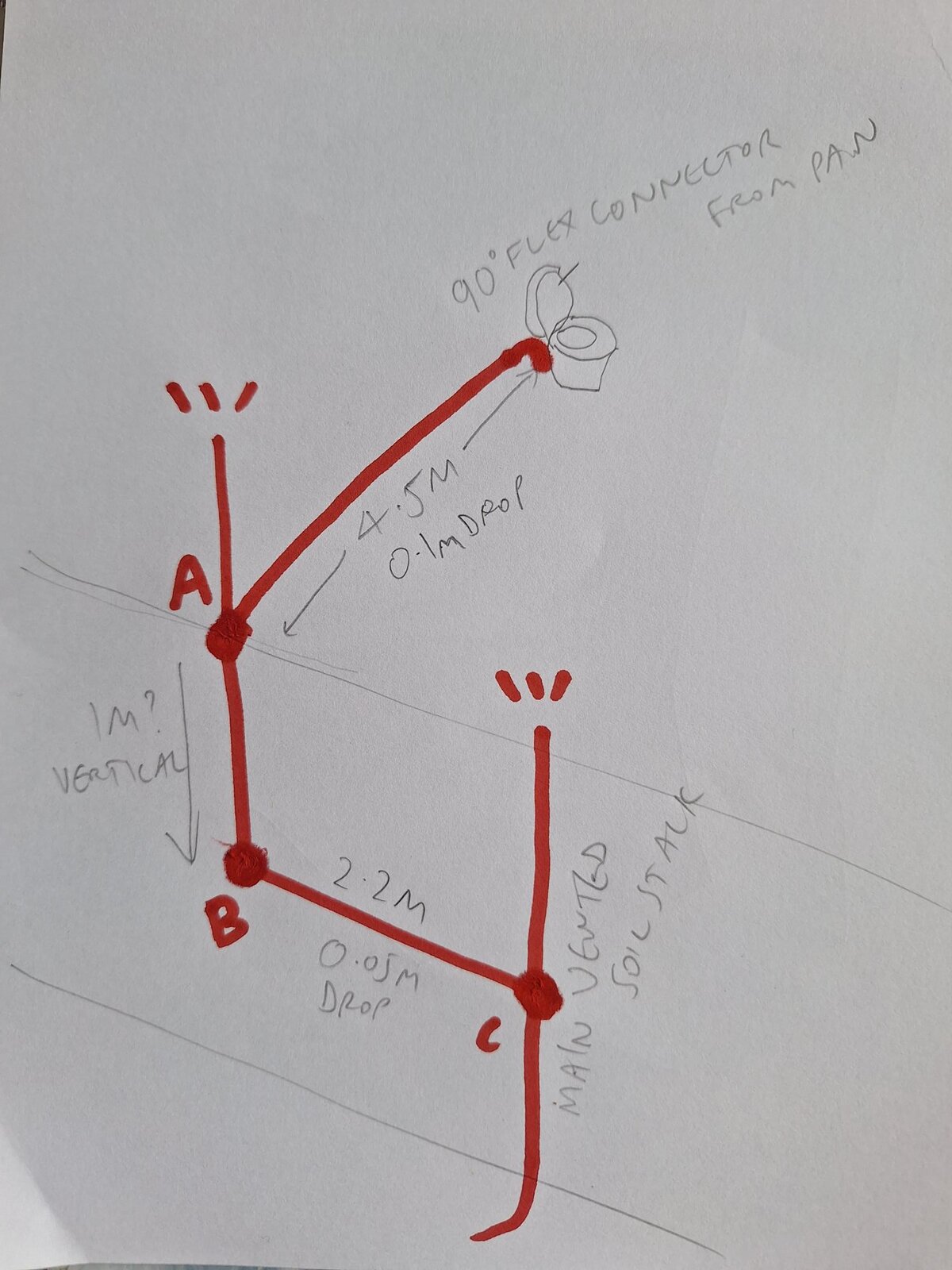

What length of vertical section between A and B would be best? I guess bend B will need to be well supported with clips to take the weight of falling waste and water - I thought maybe a long radius bend at B but they don't seem to do them for above-ground plastic 110mm drainage.
Should the new vertical section A-B continue up and be vented at the top? Or is the ventilation in the main soil stack enough?

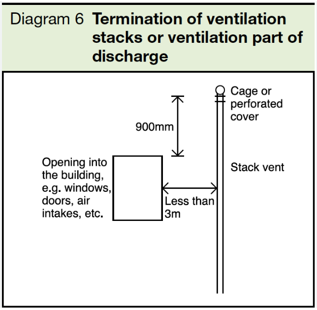

Been up and looked and getting a vent vertically on to that branch would be a pain to get 900mm above nearest window, it would have to stick up about 1500mm unsupported above gable roof.
But I could run the vent at 45degrees up towards the other stack. In that case is there any point keeping the two separate? Or could I join the second one back in to the main stack to share its vent? It would be well above all the soil connections.
Something like this:
