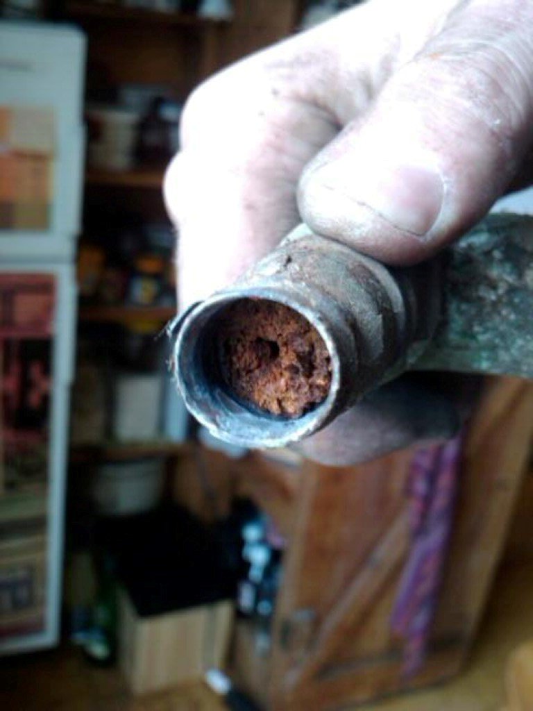

fitted central heating in my house 1979 and a good 9 months latter one of the many joints sprang a leak
Just 1 what about any micro leaks allowing air to be pulled into your system and joints just about watertight with flux.
the flux had filled the hole
Examples of applying far to much flux and not correctly testing.
