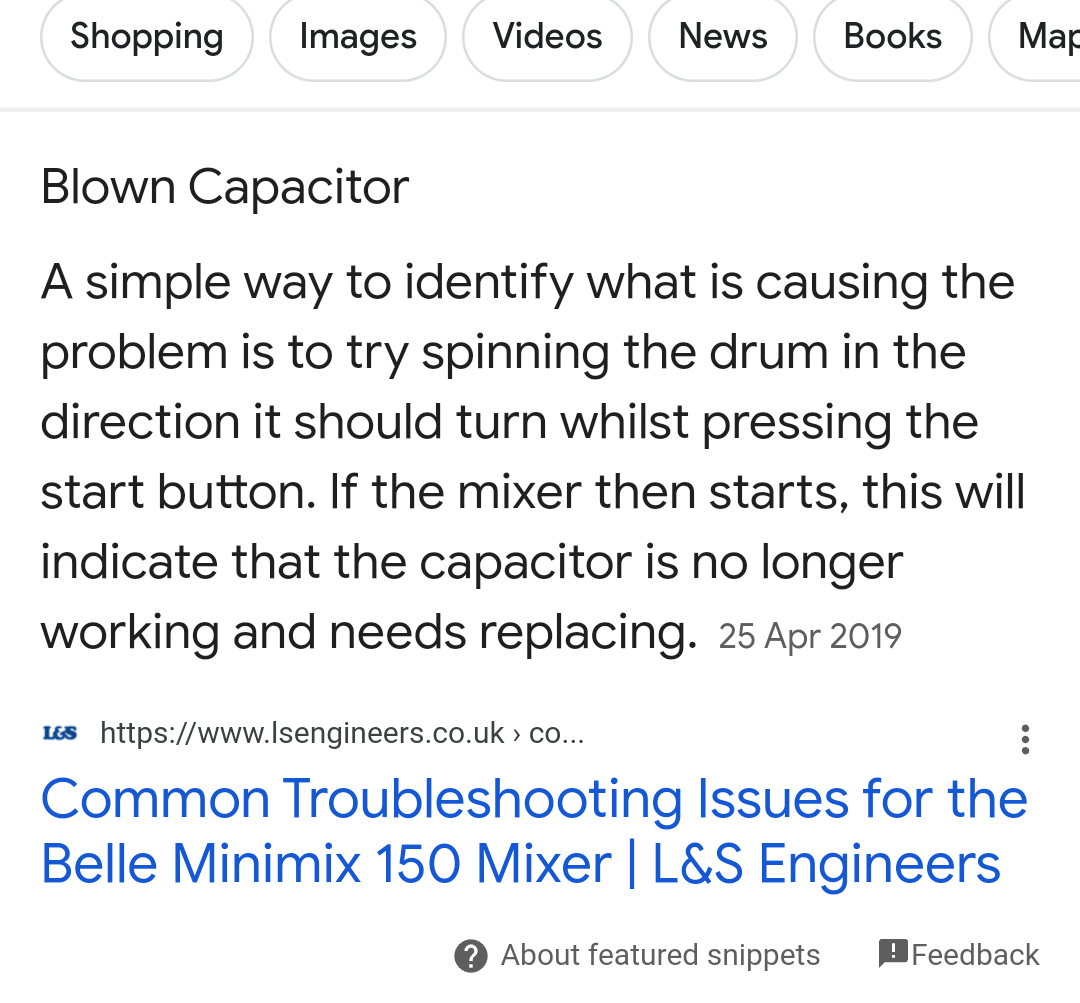

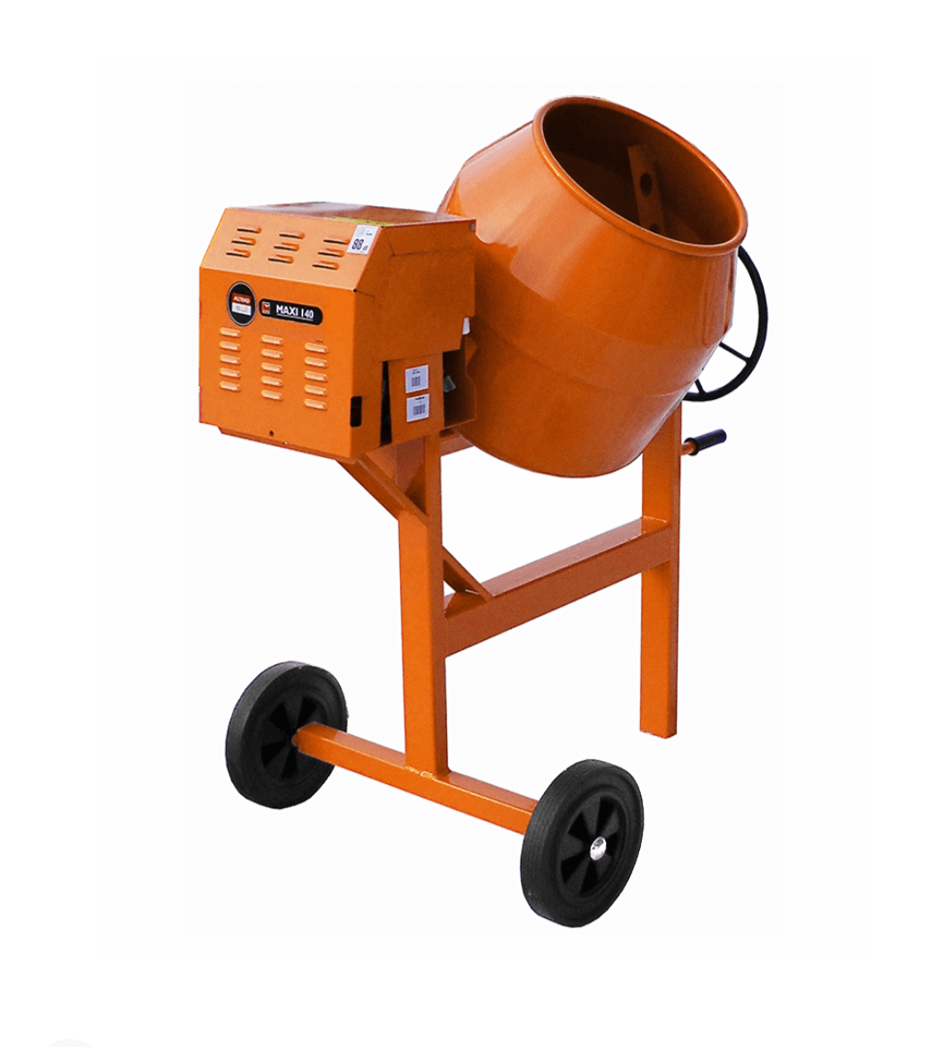

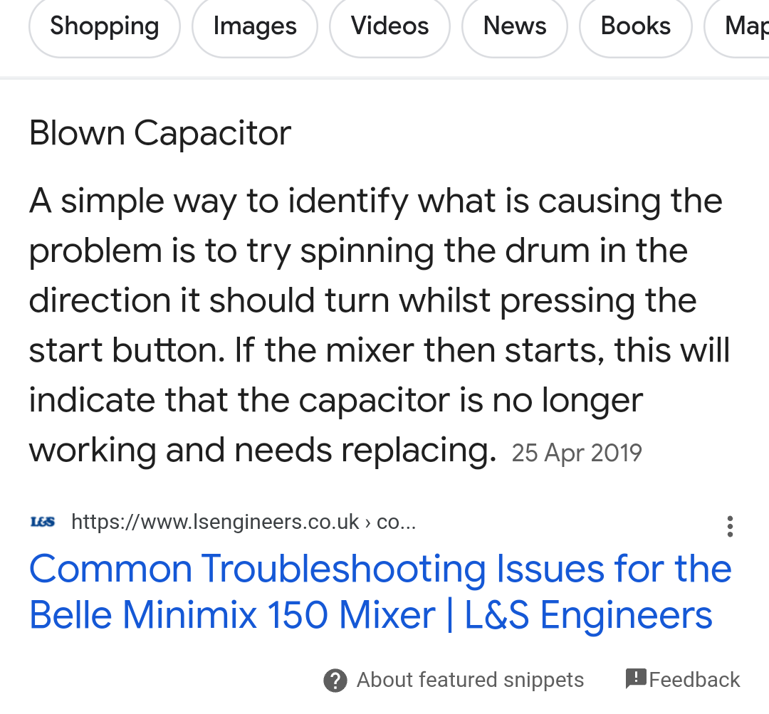

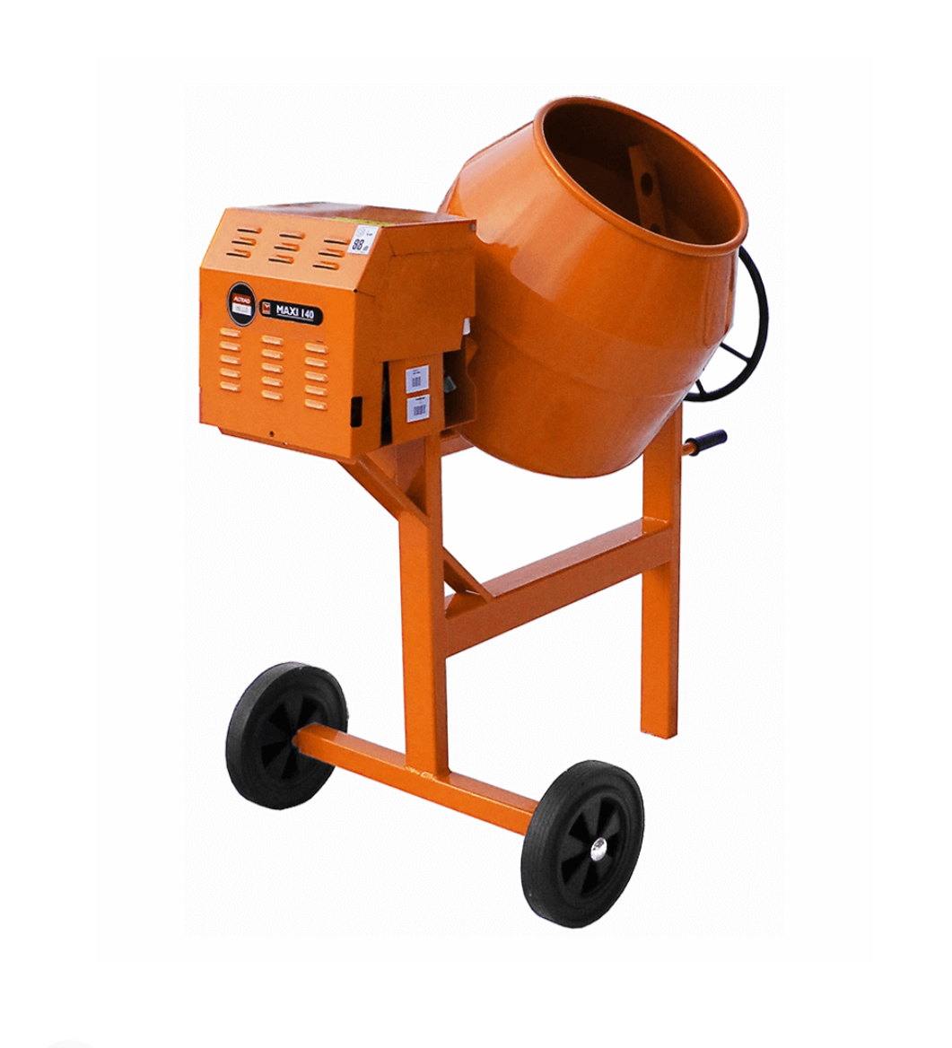

I had one with a knackered capacitor, I had to spin the drum then switch it on to get it going, a bit like hand cranking an old car. I have a belle maximix now, if its really full I usually put the drum vertically when starting.

The capacitor helps kick start the spinning process. The inertia required to start the spinning is pretty high.
My heat pump tumble dryer's motor recently started buzzing rather than turning the drum, if I gave it a gentle (rotational) nudge, it would start spinning. I replaced the capacitor and all was good. Once a motor is spinning, it is happy but it needs a kick start to get going- hence the capacitor.
