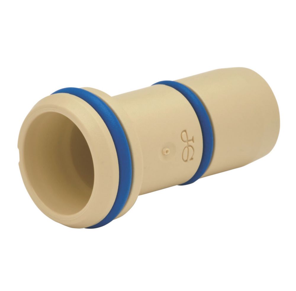

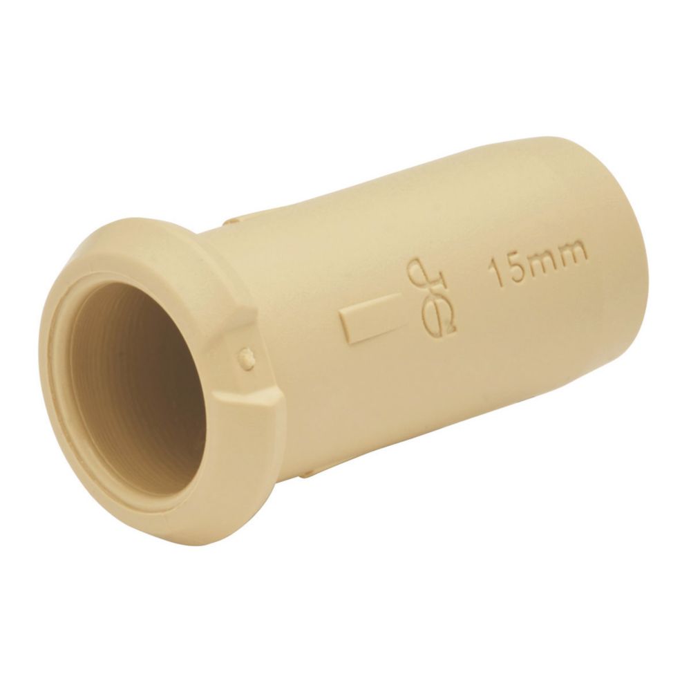

By 'plain insert' do you mean one without a rubber o-ring on the exterior?
I.e. this:
64318_P
not this:
15422_P
