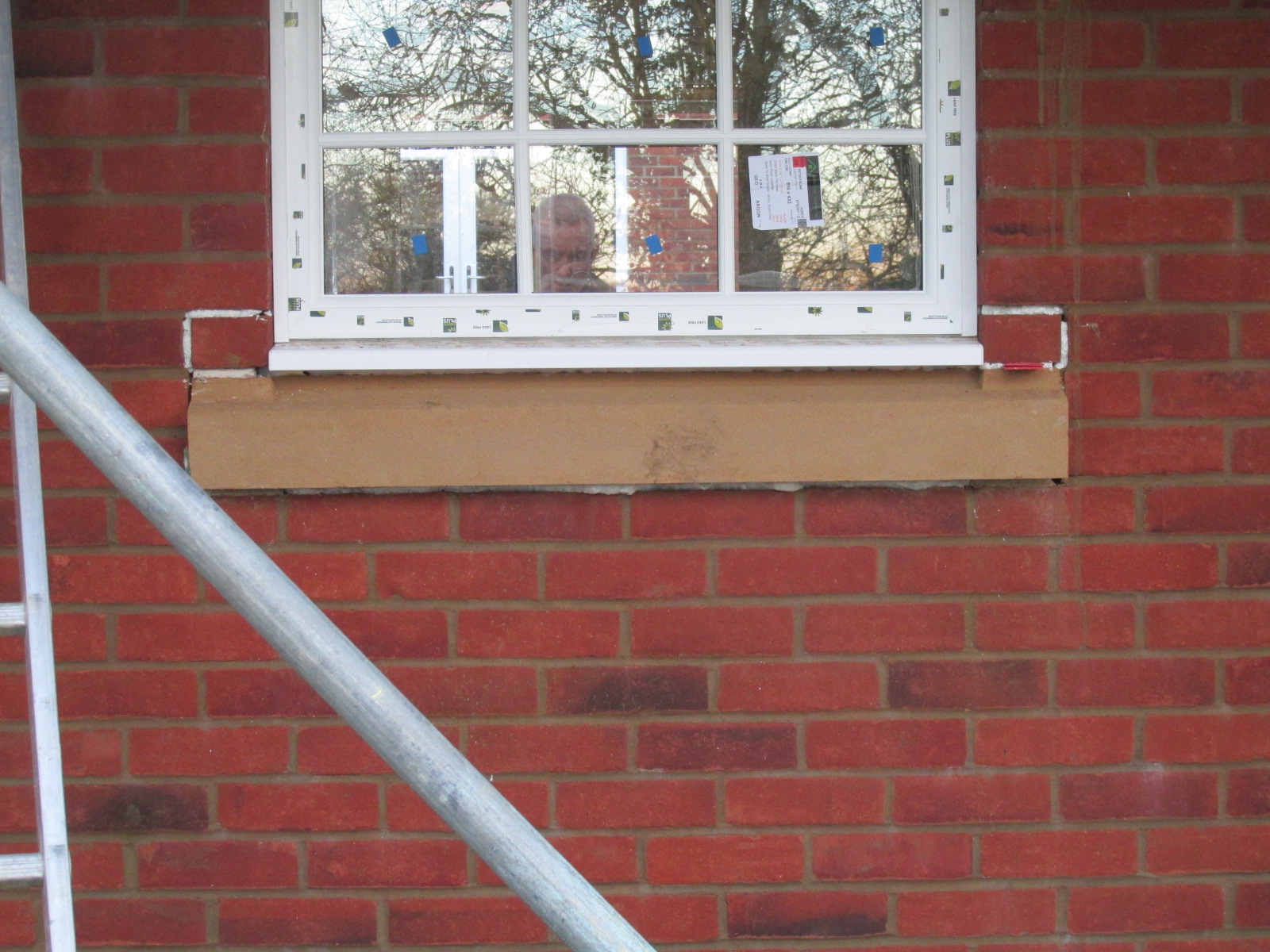

We are having an extension built and are a bit worried that some of the work is sub-standard.
The latest thing is how they have installed the stone sills under the windows.
They set the stones on pieces of plaster board - (to get the correct gap I presume) and installed the windows. They have now filled around the stones with expanding foam - it looks like they have removed the plaster. I would have thought that these stones would be built into the wall with mortar - as they are on the main house.
Pic below shows one of the windows, the stone is completely surrounded by foam, no mortar whatsoever - though I suspect they will point over the foam at some point. I can push a metal rod right through. All the stones are done in this way.
Before I get the builder wound up by questioning him again, is this an acceptable way of doing this?

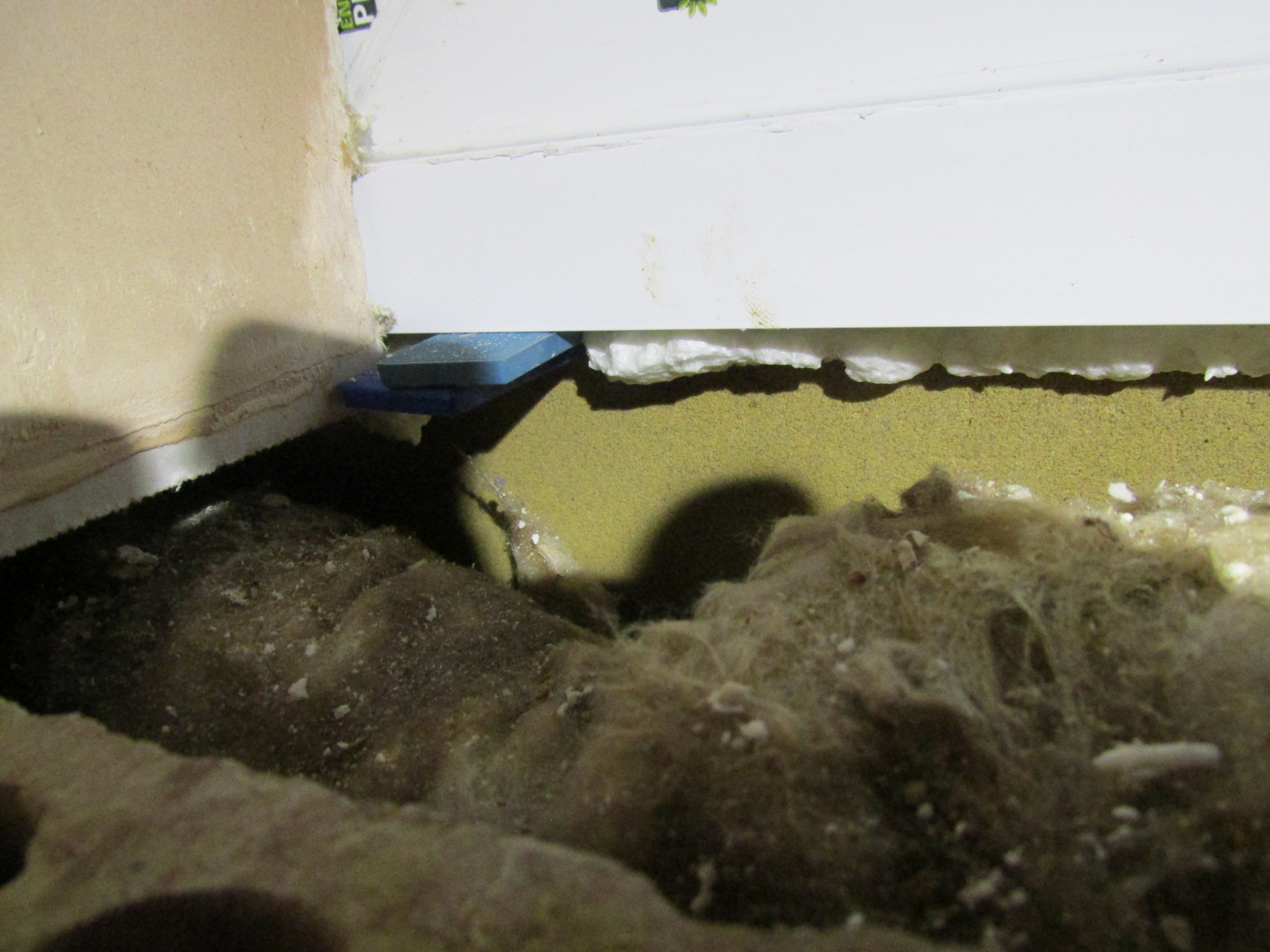

First pic is a view into the corner of the window from the inside. You can see the sill (which is flush with the inside of the bricks) the window and the plasterboard butting up to the window.

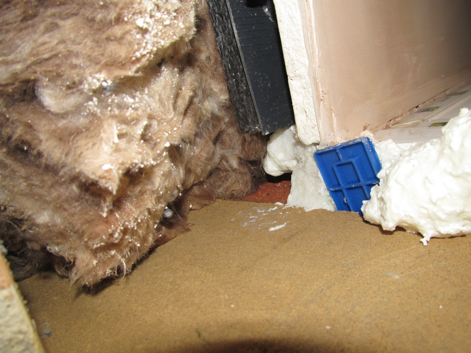

This is a different window, taken from down in the cavity looking up. Hope this helps.
Can you see a cavity tray? It should be ruining from under the stooled cill up to the inner blockwork around the level of the window frame. Or be a preformed object. If you've pushed a rod through under the cill deep enough you may have punctured it.
Basically the ideal with a stooled cill is to avoid stress, and to accommodate movement; this is why they *generally* have loose DPC as slip planes and sometimes even bed joint reinforcement underneath them. You'd bed just the stool ends and leave a free area under the cill. You generally do not mortar above the cavity tray between stooled ends. At the end of the job you use a compressible backing rod rather than foam, but you see expanding foam used alot (most foams can over time can lose elastic properties).
From your pictures it does look like the stooled ends are mortared, you can see the colour difference to the foam; so your primary worry is solved; but the other details with DPC, tray, weeps are not easily visible in your pictures.

If a cavity tray is a piece of damp proof membrane sloping down towards the outer wall then there is nothing there. They did do this in all the openings but it is much lower down and now hidden under the insulation. There is nothing I could possibly puncture anywhere near the sill.
I assume you mean something like below. This is how you say it should be done - everything else I can find online just shows them laid like bricks.
I don't think there is any mortar anywhere, the stooled ends are supported by plasterboard packing, plastic packing or foam.
I don't know anything about a window sizing survey - the builder must have arranged it.
Mike
Oh so the only thing under the stooled ends is plasterboard and not mortar?
No mortar anywhere, no damp proof membrane - just foam and plasterboard - not sure if they all have the plasterboard but they probably do.

There are bricks held in by just foam too - see first photo
Whilst it looks OK, and may well be OK once pointed up, it is certainly novel and non standard, but I'd not go as far as to say it's a bodge.
I suspect the installers were not skilled in brick laying, and have avoided smudging mortar all over the bricks - which is a good thing.
If the pointing was at least 25mm deep on each side of the wall, not a token gesture, then I'd be inclined to leave it. The alternative to remove it and have it redone with mortar may make it a right mess but not any better.
