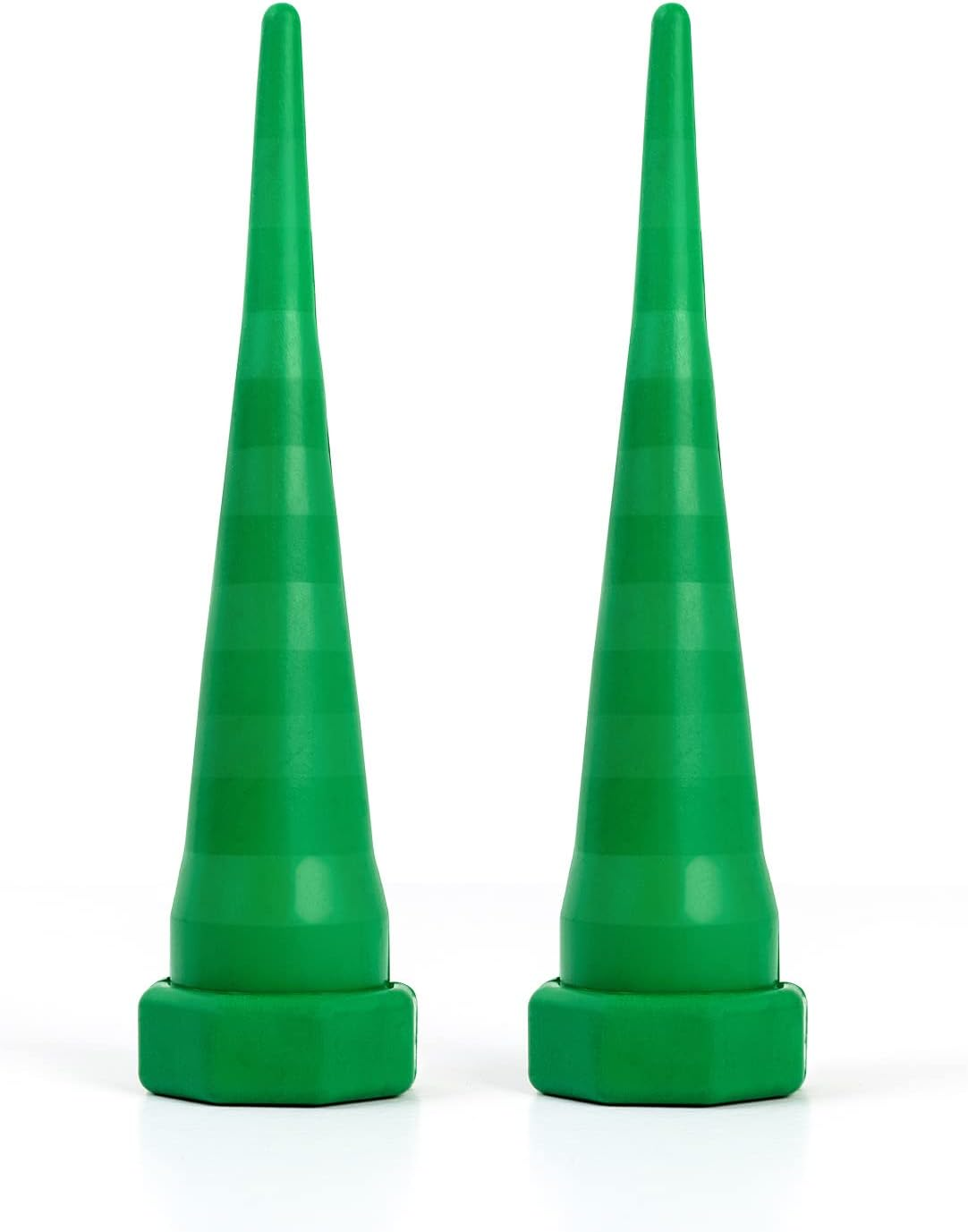

I use these - Well mine are blue but they're the same thing
I changed a a rad for a heated towel rail for someone today, had to alter pipework slightly to make it neat.
Used the bungs as shown above, lost about a litre of water before it sealed, job done.

Blimey, never seen those before. Some sort of temporary stopper?
yes - exactly that. made of silicone so they can be jammed in and they stick. I use them for rads and for bunging Cold Water Cistern feeds and any other gravity system pipework. Got me out of plenty of tricky spots before now.
Everyone thinks when they take off rads valves that the rads is going to empty all over the floor in secs, as long as the bleed screw is in and everything is tight then as suggested, the water in the rads will only slowly glug out, so plenty of time to get a bung in and only lose half a cup full if that.
Thanks for that. I might even put them on my early Christmas list!
