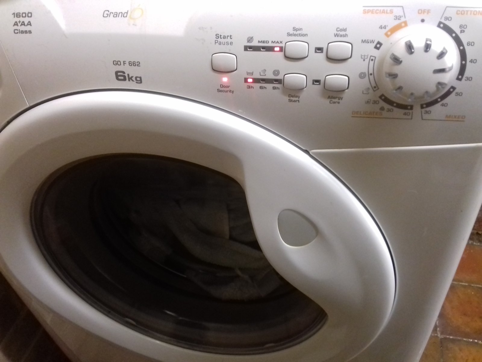

We've just bought a Candy GO F 662 washing machine, second hand.
It worked fine for the first 3 or 4 washes, but now it's just stopped.
When I try and start a wash, the "Door Security" light, the "Max" light and the "3h" light stay on - see photo, below.
Water does flow into the "washing powder tray" (or whatever it's called!), but nothing turns.
Then after a couple of minutes or so, the "Cold wash" button blinks twice.
What I've tried:
1. I unscrewed the drain cover cap (located at the front/bottom/left of the machine) and a fair amount of water came out. I pulled the cap off (had to use some plyers) but there was just another black plastic piece behind which I couldn't get off. I couldn't see any signs of a blockage, though.
2. I removed the water inlet pipe from the back of the machine. Disconnected, I opened the tap on the wall and water seemed to come through fine.
3. Back on the washing machine side, I noticed there was some muck around the water inlet filter. I washed the muck away and tried to remove the filter - could turn it but not remove it (maybe you need needle nosed plyers for that?).
Reconnected the water to the machine and retried, but still no luck.
So no idea what the problem is. Seems strange that it worked fine for a few washes then has just stopped.
Any suggestions/ideas much appreciated.
Thanks,
James
PS - The door doesn't seem to open again unless I open the drain cover again - I'd say about a litre or two of water comes out and then the door will open again. Does it sound like a blockage somewhere??
